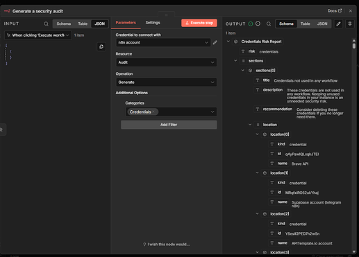

It works on my side (n8n v2.8.3):
No, Can you share any screenshots or explain how you’re getting that error?
Edit: You may need to specify the Categories option to narrow the response to only that section?
