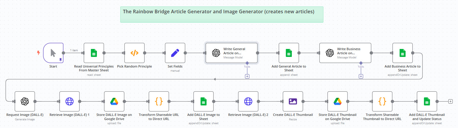

Could you copy and paste your workflow into the field that appears when clicking ‘</>’ on the forums here to see the logic that is occurring. And potentially screenshots of detailed errors.

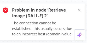

I am using hosted n8n. Here is the workflow and here is the other error I get regularly, “The connection cannot be established, this usually occurs due to an incorrect host (domain) value”.

That helps, but could you provide the actual flow? I am curious if there are dynamic fields or inputs and that may cause some downstream issues.
GPT also has been under heavy load since their image and new chat releases. I might wager if its random (with intermittent success), that you could be accessing a high load route or based on locale. Try adding a retry on error or other error handling.
