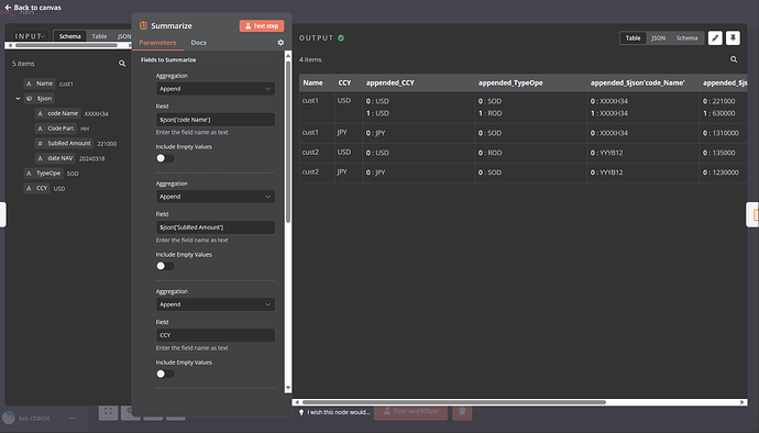

I am a beginner in n8n. I am reaching out to you because I need your help with performing a calculation in the workflow below. I am stuck at the last two nodes: “summarize” and “result.”
For the “Summarize” node, I need to apply the following business rule (for the “cust1” case):
If the amount in the “SubRed_Amount” field corresponding to “SOD” in the “TypeOpe” field is greater than the “ROD” amount, then calculate and display the difference (409000) in the “subRed_Amount” field and indicate “SOD” in the “TypeOpe” field (ultimately resulting in only one line).
If the amount in the “SubRed_Amount” field corresponding to “ROD” in the “TypeOpe” field is greater than the “ROD” amount, then calculate and display the difference (409000) in the “subRed_Amount” field and indicate “SOD” in the “TypeOpe” field (ultimately resulting in only one line).
I hope the description of the issue I am facing is clear and explicit enough.
Thank you in advance for your assistance.
Best regards.
Nodes on canvas :
Ouput returned on “Summarize” node :
i would like just 1 line for cust1 (SOD or ROD with the calculated amount on the ad’hoc field)

Can you provide an example output of Extract from file node?
Hi barn4k,
you will find hereafter an example output for the node summarize :
“Name”: “cust1”,
“CCY”: “USD”,
“appended_CCY”: [
“USD”,
“USD”
“appended_TypeOpe”: [
“SOD”,
“ROD”
“appended_$json’code_Name’”: [
“XXXXH34”,
“XXXXH34”
“appended_$json’SubRed_Amount’”: [
221000,
630000
“appended_$json’date_NAV’”: [
“20240318”,
“20240318”
“Name”: “cust1”,
“CCY”: “JPY”,
“appended_CCY”: [
“JPY”
“SOD”
“XXXXH34”
1310000
“20240317”
“Name”: “cust2”,
“CCY”: “USD”,
“appended_CCY”: [
“USD”
“ROD”
“YYYB12”
135000
“20240318”
“Name”: “cust2”,
“CCY”: “JPY”,
“appended_CCY”: [
“JPY”
“SOD”
“YYYB12”
1230000
“20240318”
Thank you for your help
Best regards
Seb
