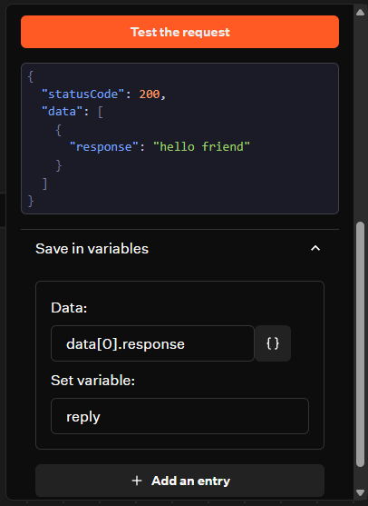

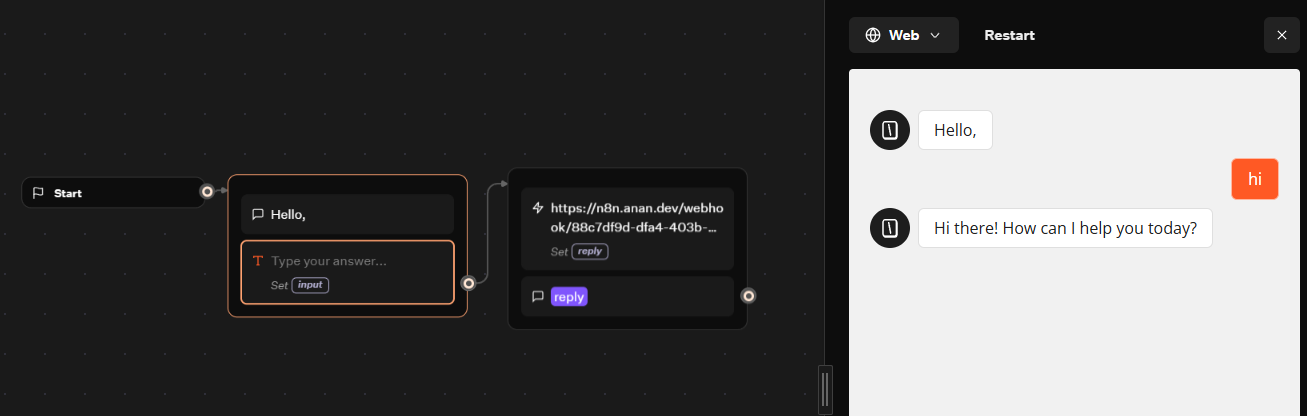

Hi @The_Nutrient_Project
I think it’s something related to the Typebot workflow, but I’ll give you the general solution since I use Typebot with n8n as well,
All you need to do on the n8n side is set up a proper webhook workflow that outputs something, for example, an AI agent that takes the user input as a parameter.
On the Typebot side, you’ll need to add an HTTP request block that calls the n8n webhook with your input parameter, save the response in a variable, and then display it.
To be able to set these variables, you first need to test the HTTP request, and then save the variables.
As I mentioned earlier, this is more of a Typebot-related question rather than an n8n one — but hopefully this helps!

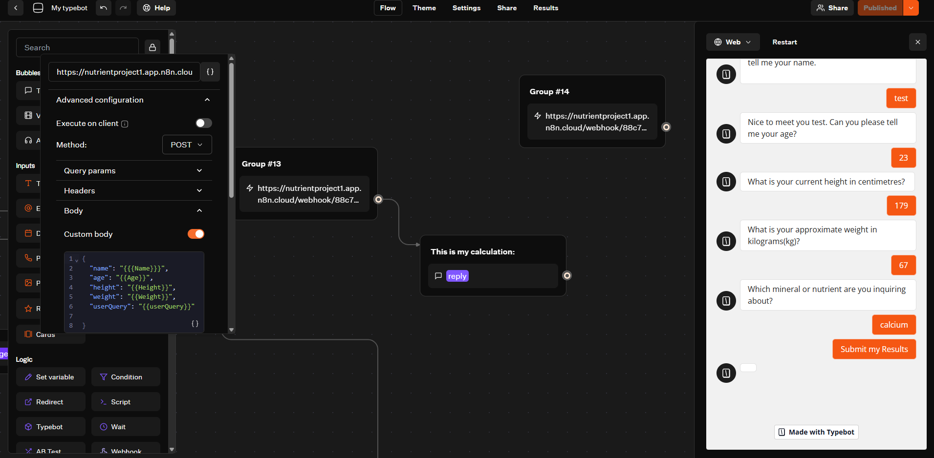

Hello @mohamed3nan,
I understand this is a typebot-related issue therefore if it is not allowed here, then I understand.
In my typebot http request node, I am unable to set the reply from the n8n output as a variable so I have screenshotted my parameters.
If you have any suggestions, I will gladly appreciate it :slight_smile:
When I test it, the webhook itself is successful:
“statusCode”: 200,
“response”: “[{"output":"After careful thinking, here are the details:\nNutrient/Mineral: Calcium\nNutrientRange: The recommended daily calcium intake for adults 51 years and older is 1,200 mg.\nIf you want more information to help support your options, please consult a health professional such as GP or pharmacists.\n"}]”,

Yes, after clicking “Test the request” you’ll see the response, and you should then save it in a variable so you can use it and display it in your chat.
Make sure you’re mapping the data correctly, and ensure you create a new variable instead of overwriting an existing one..
Amazing I have tried it and it is now fully functional! Thank you, you have saved me countless hours of debugging and confusion!
