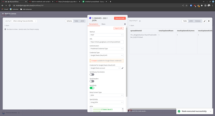

When using the HTTP node with body settings of JSON/Using JSON, n8n crashes and needs to be brought down and back up. If I instead use Raw, it works. See attached workflow nodes with CRASHES vs WORKS HTTP node configurations and the provided docker error log.
UI: Lost Connection
Log: n8n_1 | 2023-04-10T16:42:44.435170671Z TypeError: The "chunk" argument must be of type string or an instance of Buffer or Uint8Array. Received an instance of Object
Share log output
Log output from sudo docker-compose logs -ft
