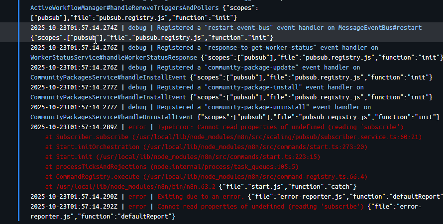

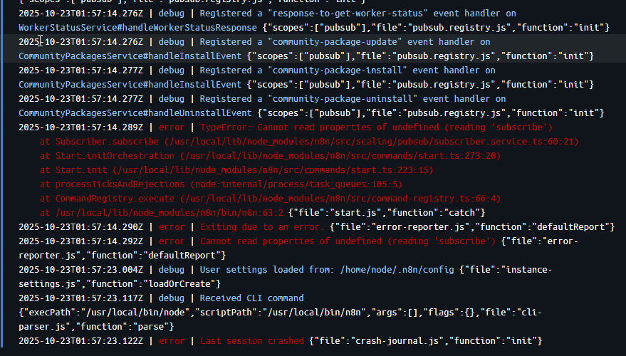

2025-10-23T01:57:14.289Z | error | TypeError: Cannot read properties of undefined (reading ‘subscribe’)
at Subscriber.subscribe (/usr/local/lib/node_modules/n8n/src/scaling/pubsub/subscriber.service.ts:60:21)
at Start.initOrchestration (/usr/local/lib/node_modules/n8n/src/commands/start.ts:273:20)
at Start.init (/usr/local/lib/node_modules/n8n/src/commands/start.ts:223:15)
at processTicksAndRejections (node:internal/process/task_queues:105:5)
at CommandRegistry.execute (/usr/local/lib/node_modules/n8n/src/command-registry.ts:66:4)
at /usr/local/lib/node_modules/n8n/bin/n8n:63:2
2025-10-23T01:57:14.292Z | error | Exiting due to an error.
2025-10-23T01:57:23.122Z | error | last session crashed {“file”:“crash-journal.js”,“function”:“init”}
