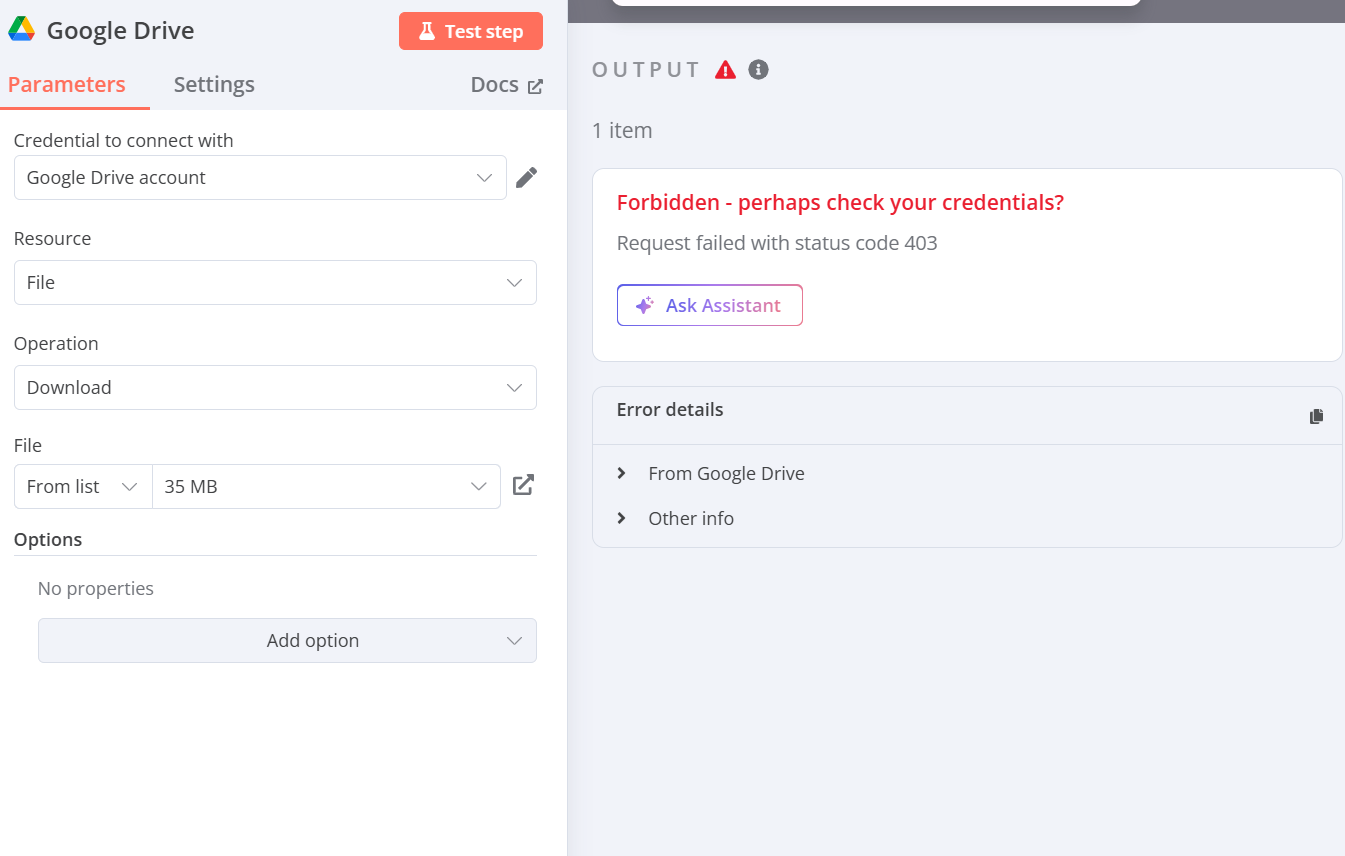

The workflow fails at the circled node.

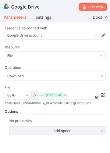

Yes, Are these your configurations?
Also, I tested a 20MB file on my end, and it worked without any issues…

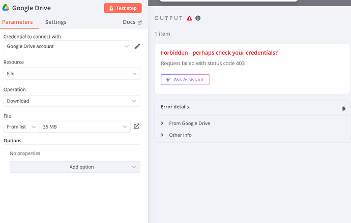

I did what you have done but it shows that same error that’s been occurring for me. Although it says ‘perhaps check your credentials’, I know it’s really to do with size since if I do it for files size <10MB, they are downloaded without any issue.
