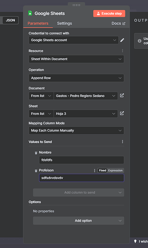

Hi, I tried everything but the Google Sheets node doesn’t create a new row in my Google Sheets document.
The authentication seems to be fine, I am able to retrieve the tables and columns, etc.

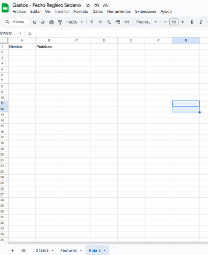

But when I check the Google Sheet nothing has changed, I have looked at the bottom of the sheet and there’s nothing either.
I am running it manually directly, but that’s my complete flow.
I also tried creating a new Sheet and it also doesn’t work there either.

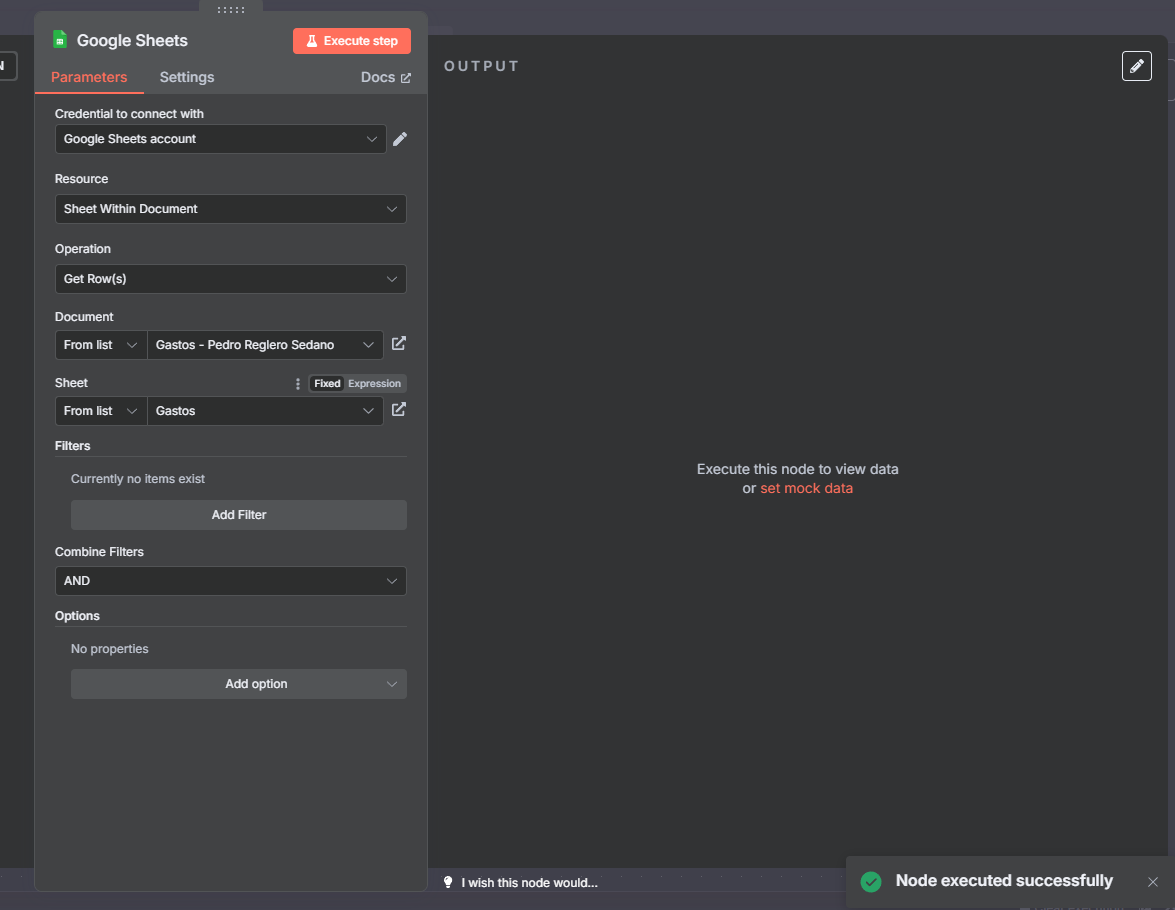

If I try to get rows in a different paper in that sheet that has rows, the node doesn’t return anything

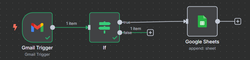

Take a look at the screenshot you shared. Your if check is going to false which is preventing the Google sheet node from running
check why it’s going to false or temporarily remove the if and see if that works for you

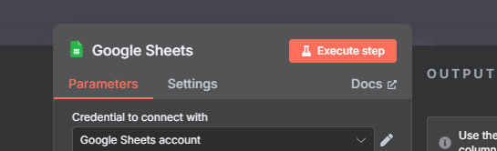

I am running the Node directly by clicking on Execute Step.
running it like that still relies on previous nodes data, so it will act the same way as testing from the canvas.
Try what i suggested by removing the if temporarily to see if it works.
