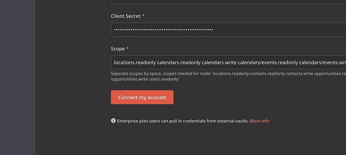

I currently have n8n hosted in Railway. I’m having issues connecting it to GHL using oAuth 2.0.
In my normal n8n cloud account everything works great, but I’m always getting errors during authentication using it via Railway.
I have an App setup in GHL Marketplace, with selected scopes, client keys, and Redirect URLs. I tried the provided callback URL, and also switching the first part of the URL with my custom domain, but no luck.
I also tried using a Generic HTTP oAuth 2 API request, but I’m getting similar errors.
Anyone has some insights on it?
Thanks!
Messing with different setups I just got 404 or 400
n8n version: 1.63.4
Database: Postgres
Running n8n via Railway Template

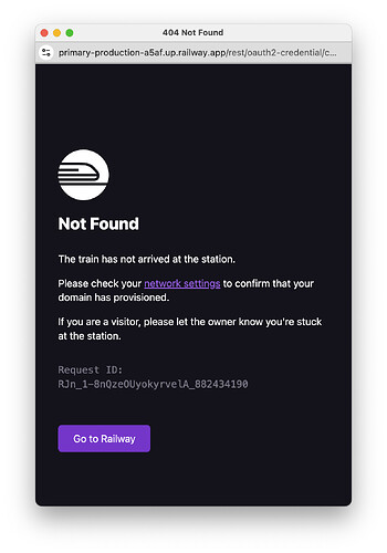

Callback URL looks good. Can you show how the error looks?
Seems something is missing in the configuration
Absolutely!
Hey @Simon_Kang,
Can you make sure you have WEBHOOK_URL set to https://simonkang.up.railway.app
Hey, @Jon! Thanks for the reply. Yes, in railway I set the variable WEBHOOK_URL to https://simonkang.up.railway.app, but no luck.
