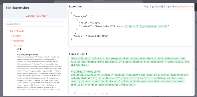

I am trying to convert my input into HTML code only. But the output gives me some JS variables as below (see screenshot). It only happens when I use the dynamic variable {{ $json.life_and_background }}. How can I fix this issue and get the desired output? Many thanks for your help!

From my understanding, the variable that I use from the previous node alters the json. Because there are some “” and /n in it. I have tried different models. It works well when I copy paste the plain text directly in the json but not when I use the variable

you need to switch the toggle so it evaluates the expressions :wink:
Hi Ria, thank you for your reply! The json, looks fine so that’s why I don’t understand why the output comes out with some JS instead of HTML…
