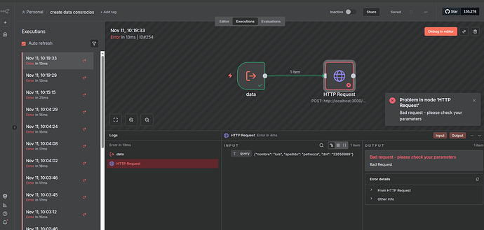

Thank you for your response. I will try to be clearer. I am targeting my local machine as I am testing.
The flow starts in a previous workflow with an AI agent.
In this workflow, I receive the data and want the HTTP node to insert it into the database.
If I put hard data into the HTTP node, the data is correctly inserted into the final database through the API.
The general idea is to tell an LLM something like, “Please create and insert 20 people with random data.”

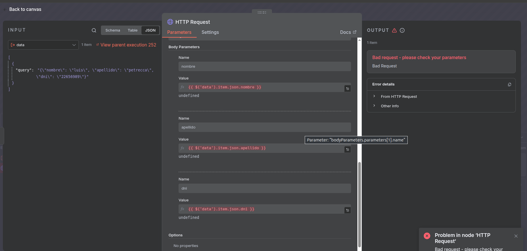

From WA (workflowA) to WB, the data goes well. It even enters the http node input correctly (as can be seen in the image). But for some reason, it does not recognize the json variables and always reaches the API with empty parameters.
I have tried a thousand different ways.
{{ $json.name }} {{ $item.json.name }} {{ $query.name }} , etc., etc., etc.

{{ $json.name }} {{ $item.json.name }} {{ $item.json.fields.name }} {{ $query.name }} , etc., etc., etc.
the incoming data is not the valid JSON, the escape characters (“\”) are messing it up so everything after “query” is one long string. You might want to update your prompt to have the model validate that before creating output, best on an example. Then the “{{ $json.query.nombre }}” should work just fine :slight_smile:
This is because the query variable you are receiving is not a JSON but a string with escape characters. You need to specify in the subworkflow, the exact variables you need there and map those from your other flow to this one. That’s a very common problem when dealing with sub-workflows.
If you still do not understand and need help with that, please share the exact workflows and I can help you map that.
thanks !! That was the problem. I thought it was just a matter of it not looking nice. But in reality, it was a string. I solved it with a “code” node in the middle that takes the string and returns the JSON correctly.:slightly_smiling_face:
