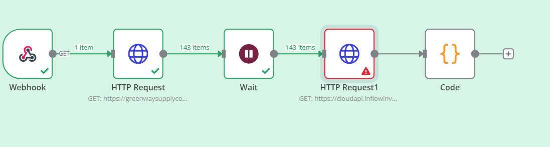

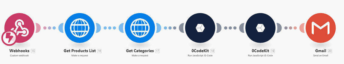

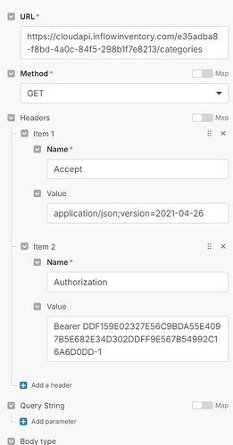

I encountered a rate-limiting issue while working with n8n. The first HTTP module request works fine, but when I attempt a second request to fetch the list of categories, it fails with a “too many requests” error. Interestingly, the same workflow works perfectly in Make.com.

Is there a way to get all inputs from the previous node only? ithink the {{$input.all()}} gets the output of all previous nodes.

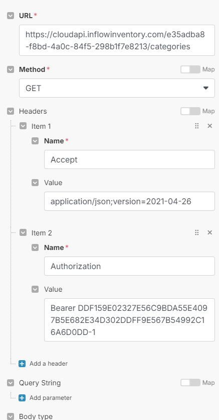

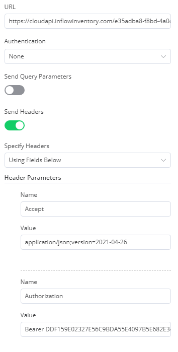

@Janna.greenway I notice that in your workflow the Authorization token is the same for both API’s. Maybe double check the authorization for the failing API request against what you have in make.com?
If the services are separate then they would typically have different authorization tokens.
Sometimes an API will return “429 Too many requests” instead of “403 Unauthorized” when the authorization is wrong because the rate-limiting is based on the authorization token.
Also, have you tried the request using another HTTP client such as curl or postman to verify the headers that you’re passing to the API?
Yes, I was able to get the categories in Postman using the same authorization tokens. In n8n, the authorization is the same as in Make, which is working correctly. So the token itself doesn’t seem to be the issue.
Let me know if you have any other thoughts!

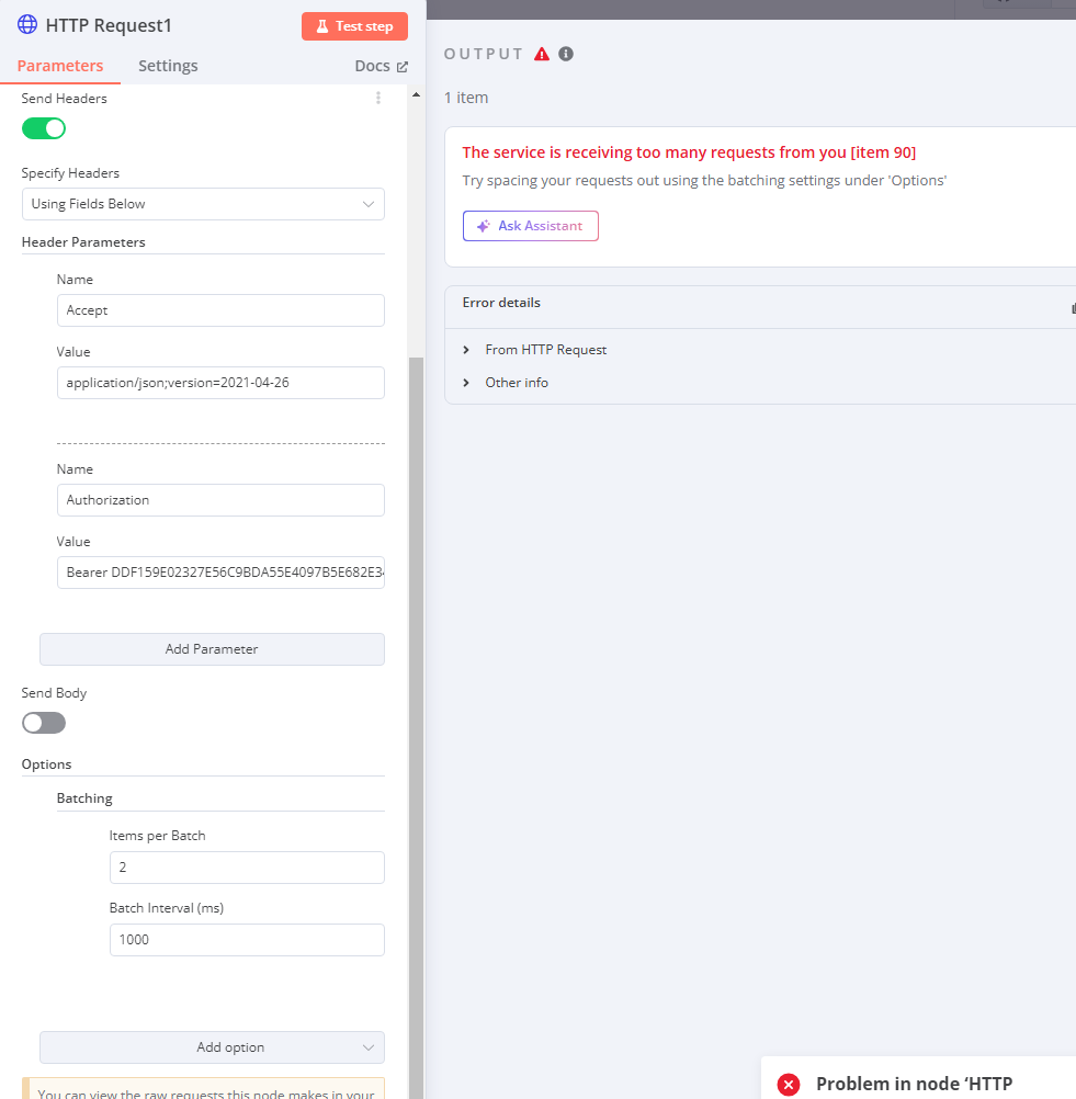

Hey @Janna.greenway, For your 429 error, try adding batching to the HTTP Request node (Options > Batching, e.g., 5 items, 1000ms) since Postman works but n8n’s hitting the API too fast—also, $input.all() only pulls from the last node, so check its output if data’s off.
@Janna.greenway Thank you for the context! Looking at inflow’s API documentation:
If you send too many API requests in a short time, the inFlow API will return HTTP status code 429 Too Many Requests.
If you encounter this limit, we encourage you to try to reduce the number of API calls required, or contact us for help if you are unable to do so.
Currently, the limit is set to 60 requests per minute but this is not yet finalized and may change.
I think @Yo_its_prakash is right, if it’s working in postman and make, then indeed n8n could be hitting the API too fast, or there’s duplicate calls. As their docs indicate that they accept 60 request per minute (1 request per second).
Thanks, @limecodesyan and @Yo_its_prakash! I appreciate the insights.
I’ve tried adding both batching (50 items, 1000ms batch interval) and a 1-minute delay step, but I’m still getting the same 429 error in n8n. The strange part is that in Make, I don’t have any wait or batching, and it still works fine without hitting rate limits.
@limecodesyan I appreciate the affirmation on my solution. but it seems even after batching there are quite few issues.
@Janna.greenway Could make the batch size as 2 just for debugging purpose
Thanks, @Yo_its_prakash and @limecodesyan! Yeah, even after batching (tried reducing it to 2 items per batch with a 1000ms interval), I’m still hitting the 429 error.

That’s a good point, @Yo_its_prakash. The funny thing is this is already the third brand-new workflow I’ve tried, and I tested it a few days ago too—same issue every time. So if n8n Cloud is temporarily blocking it, it seems like it’s not resetting properly for my account/workflow.
the client’s API allows 60 requests per minute (1 per second), and I’ve already tried spacing them out, but n8n still gets blocked while Make and Postman work fine.

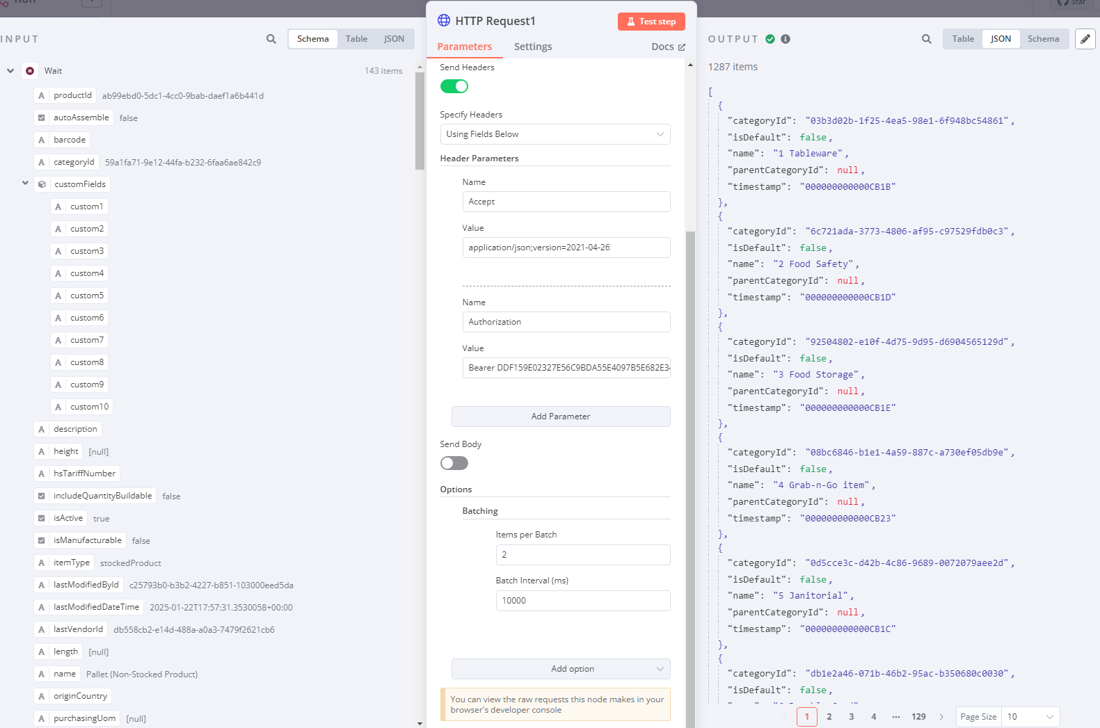

I was able to make it work by increasing the batch interval instead to 10000ms. Thank you so much for your help @limecodesyan and @Yo_its_prakash!
If this (The Batching with interval Comment) helped, please consider marking it as the solution.
Also i would like to add a proper time interval, the final minimal interval for this is:
Batching 1 per 1000ms
