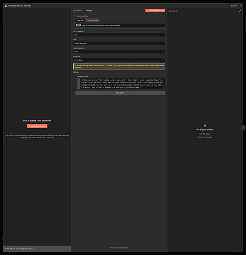

N8n in local test webhook
Webhook not responding in both test and production mode
I created a simple webhook and I’m trying to test it, but when I click “Listen for test event” and open the test URL in my browser, nothing happens - the webhook keeps waiting indefinitely.
I tried the following:
Restarted the Docker container where n8n is running on my PC
Activated the workflow and tried hitting the production URL (without -test)
Tried different browsers
None of these worked. The webhook never receives the request.
Running on: Docker (local)
OS: Linux
Has anyone experienced this issue? I found GitHub Issue #15586 which describes the same problem, but it was closed without a fix.
Any help would be appreciated.

curl -v http://localhost:5678/webhook-test/marcar-atendido
Returns 404: “The requested webhook is not registered” (even while “Listen for test event” is active in UI)
curl -v http://localhost:5678/webhook/marcar-atendido
Hangs indefinitely (no response, had to Ctrl+C). The workflow IS activated.
Logs show: Node 'Webhook: Marcar Atendido' hasn't been executed

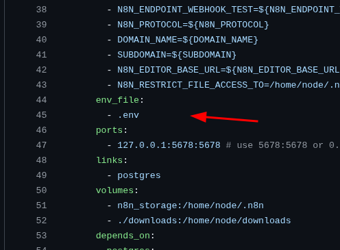

I think docker compose file is ignoring your .env file, you need to also add this to your n8n service
env_file:
  - .env
Another thing, I would try to use N8N_HOST as localhost or 127.0.0.1 too.
