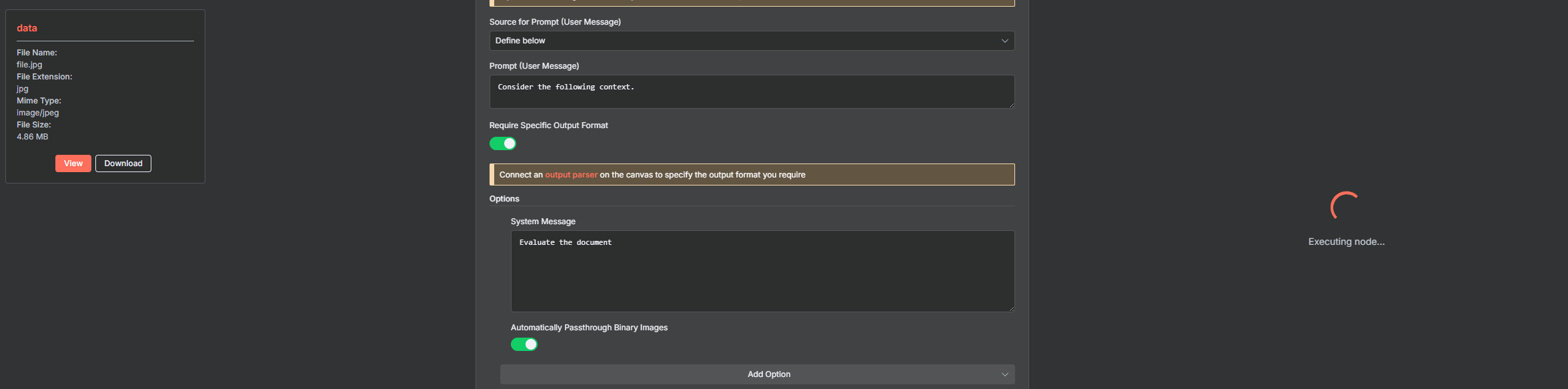

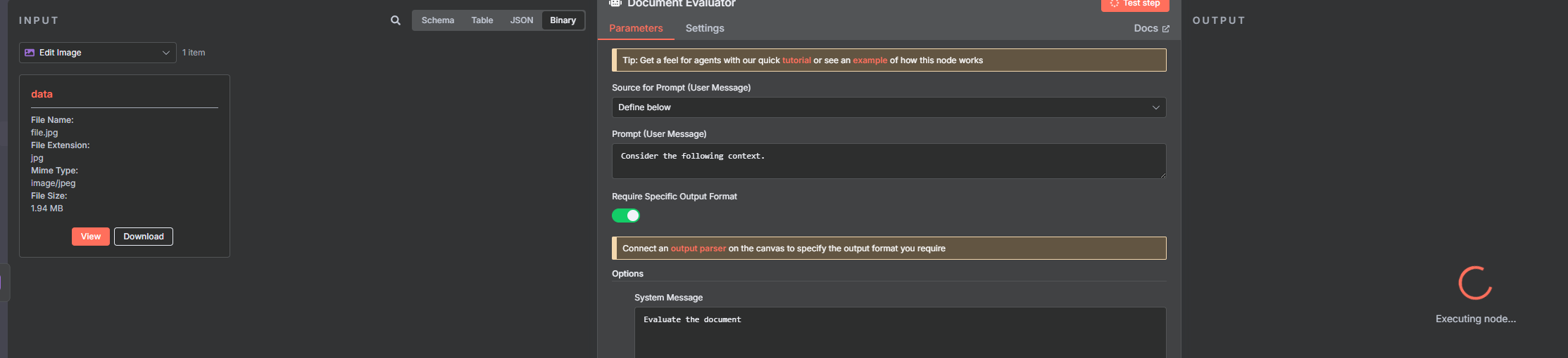

The workflow executes successfully until it reaches the AI Agent node.
Unfortunately, I cannot share the specific file due to privacy concerns. However, I can guarantee that the image is not unusually large (2296x4080), nor is it strange — it’s just a simple photo of a document:
I’ve tried resizing the image to smaller dimensions (e.g., 500x500), but the problem still occurs:
I’ve also experienced this same behavior with other specific files.
For most other files, the issue does not occur.
I’m not sure what might be triggering this behavior, but it is certainly odd. There is also no relevant information in the logs.

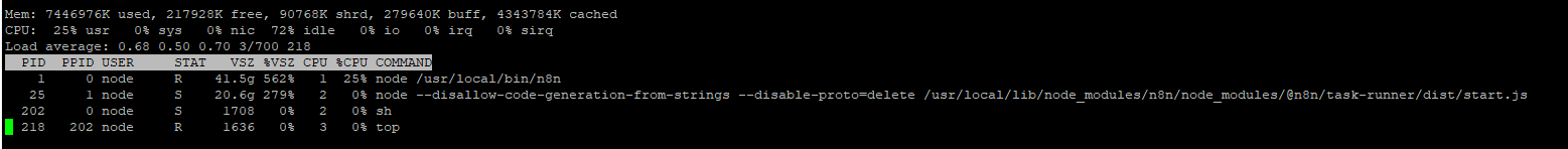

There is none. The only symptom is 100% CPU usage in the Docker container (with low memory usage). Also, the container itself is not frozen — only the Node.js process is.
This behavior requires the container to be restarted, which causes the workflow to fail.
Here’s the output of top inside the container during the freeze:
