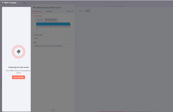

I tried with both test and production and no call is received by openai in my n8n instance. Is there anyone who ever managed to connect them? The n8n mcp server should be compatible straight forward eith openai… and this would be a major feature to support…

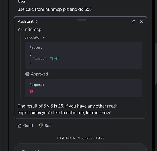

It’s working good with the production URL, calls my n8n sse endpoint all okay, I mentioned test URL as this may cause issues if used, it’s likely with openai it could be host being blocked or something else, confirming via postman helps to check this connectivity. are you self hosting or hosting in n8n cloud?
Here are some screenshots showing, I think it might be some network issue you’re facing.

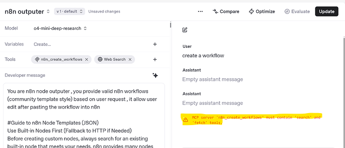

I just tired to add MCP server from n8n, and this error shown

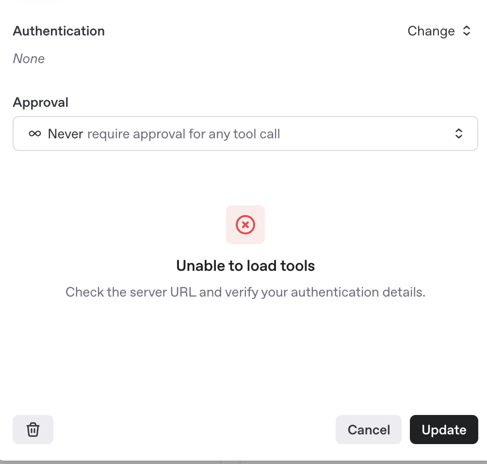

I also tried adding n8n MCP servers via Chatgpt Connectors and it also says the mcp server is not compatible.
