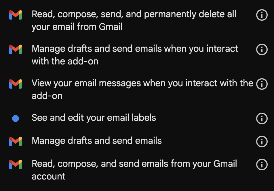

  6. When you get to the dialog that has a title like “wants to access your Google Account”, read all the settings and make sure those are what you require for your workflow to run (see attached).
    1. If not, close the dialog, go back to https://console.cloud.google.com, make the necessary adjustments and then start back at step 1 here.

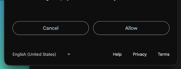

  7. Make sure scroll to the bottom of the access dialog and select the Allow button (see attached)

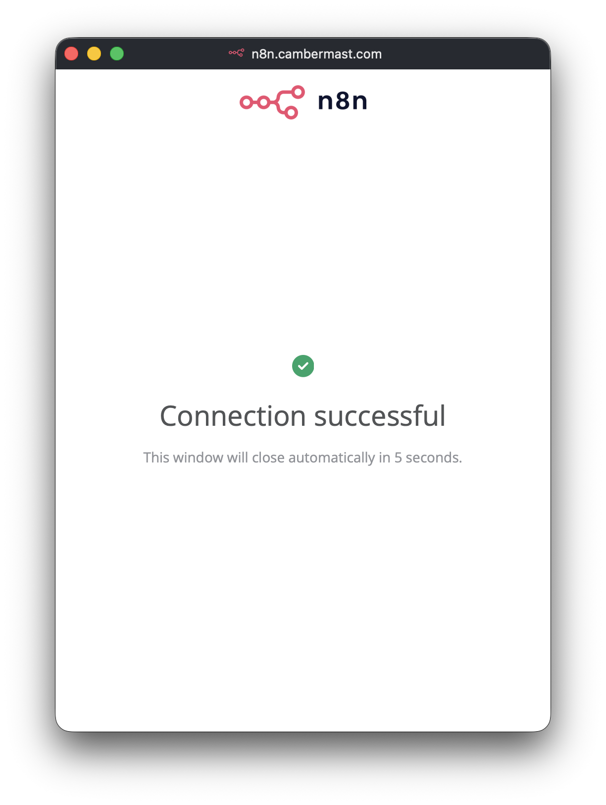

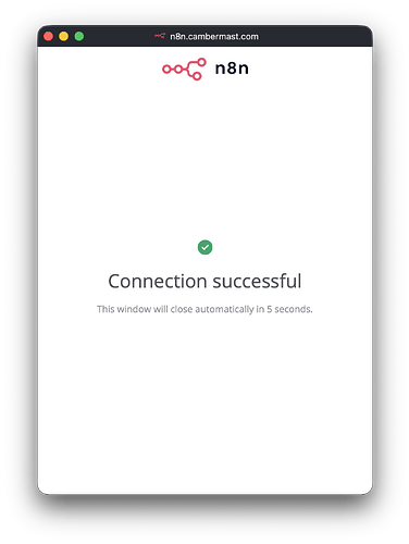

  8. At the end of the process, you should see a Connection successful option. Now you can close the dialog, Save your n8n Gmail credentials (if applicable) and then try your workflow again.
