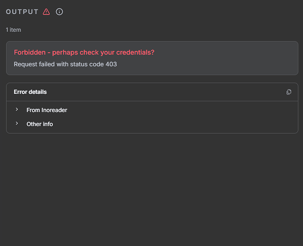

N8n-nodes-inoreader Forbidden - perhaps check your credentials? (Request failed with status code 403)
How can I fix this issue.

@Zulu_Ttk Anyone who works with inoreader in n8n experiences this issue. You install the inoreader node (1.0.5) then create the Inoreader credential, filling in the form with the content from the inoreader dev console. Scopes are exactly as documented: “read write”. ID and Secret are exactly as shown in the dev console. do the connection and that works. You can now run your workflow a number of times within 24 hours and all will work, but it will not renew.
Inoreader developer here. The issue has now been fixed, and access tokens should refresh correctly without manual intervention.
Please do the following once:
1. Reconnect your Inoreader credentials in n8n (one last time).
2. Save the workflow.
3. Let it run normally — you should no longer see daily authentication breaks.
No changes to your app settings or scopes are required.
Let me know if the issue is fixed for you.
