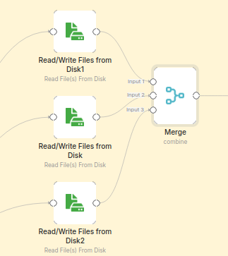

Ever since the upgrade to 2.0 my workflow is not able to run in the background. It had no issues before the update. It’s a quite long workflow, gets some data, some images, combines them, posts on X (twitter), one AI node.
If I press execute workflow there are no issues, it runs fine, around 45s. But in the background it stops after around 1s. I seems like it fetches the images but stops at the merge node.

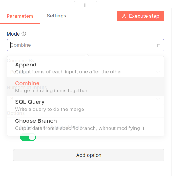

Hi @helvetic_H Set your Merge node’s “Combine Mode” to “Wait for all inputs” to resolve the background execution issue after the 2.0 update
Hi @Anshul_Namdev
Thanks for you quick answer.
I’m seeing this option. Am I missing something:
BR
HH
@helvetic_H you can use the ‘Combine’ and attach your flow branches and it should work, let me know if it helps.
hi @Anshul_Namdev
Yes, that’s what I’m using:
Or do you mean something else?
I’m not seeing an option for waiting
BR
Ah @helvetic_H just give it a run! it would not merge everything and pass forward until all the branches are executed! Cheers!
Ho maybe I didn’t explain well. This is not a change that I did. This is the state where I have the issue. Running it with the UI open and looking at it works fine. It’s when running in the background that the issue appear.
Um so the merge node gives issues when working live in background, have you tried code node to merge all the flow branches and then manually output when merged?
Thanks, so I tired this, and now it seems like I had misidentified the issue…
The node Read/Write Files from Disk is not outputting anything… “Always output data” is not an option.
I don’t know how to debug as when I’m executing manually there is no issues… Did this node change with 2.0?
