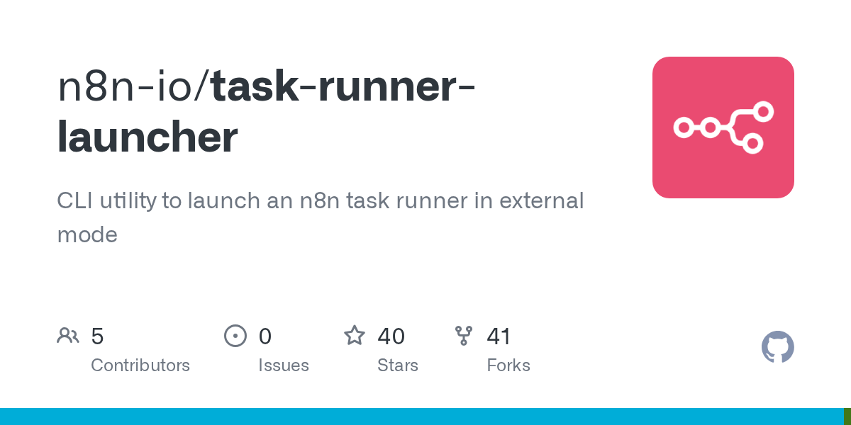

Just out of curiosity, what is the reason you’re not working with a docker deployment in a production environment? I’ve managed so many services in my time as Sysadmin, which all have been migrated to docker/kubernetes when possible.
I did some research. Generally this would be possible I assume by changing the env to external and installing the task runner launcher manually:
But I only see downsides compared to a docker based setup here.
