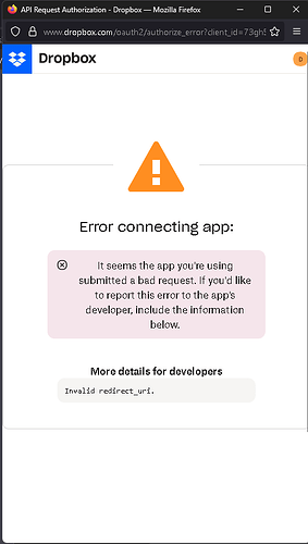

Trying to setup dropbox oauth I have similar issues
Seems to be all oauth2, so far: twitter, cloudconvert, dropbox
The URL pasted as a redirect url is the exact same as displayed in my n8n container EXCEPT again, I added https:// on the dropbox website because it will not accept a url without https://
