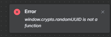

The installation went smoothly, but when I try to create a new workflow and add a trigger, I receive the following error message: storewindow.crypto.randomUUID is not a function.

I got the solution.
In the settings for n8n look for this section and select the one ‘truenas_default‘ Certificate
