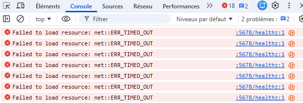

I search what was wrong be found nothing, N8N is still executing in the background, there’s no log even in verbose mode, Posgres is OK ; just the web UI is Offline…
To limit the cas I switched back my databases to MySQL, only N8N is using PosgreSQL. I have lot of less of this issues but there’re still are.
Since I’m testing the new version I only have enabled few quick workflows (execution less than 5min, less than 100 000 entries). I’m scared of the result if I enable all of them
I think the issue is when N8N is using/saving datas in PosgreSQL, the web UI goes offline, but I did’nt find a way to fix it. I didn’t have issue in the old version with MySQL.
I hope you can help me.

Logs/Errors:
And If I restart N8N while it’s Offline:

I don’t have error/warning messages.
The console only show me Timeout errors.

By default, n8n sends requests to the /healthz endpoint every few seconds. If this endpoint is already reserved for another purpose (for example, Cloud Run reserves endpoints ending with z for the platform), the requests will fail. A related issue was reported on GitHub (#25958) but was resolved in version 2.10.0. Try to upgrade to this version and configure the N8N_ENDPOINT_HEALTH environment variable to a value other than the default.
I updated to 2.10.4, and changed theN8N_ENDPOINT_HEALTH. I still have some (not a lot) net::ERR_TIMED_OUT error in the consolewhile the UI is Offline
Do you think it may be because I’m using PostgreSLQ 18.2?

I have sometimes the log “31m503 Database is not ready!”.
I see many people have error 503 recently, I still didn’t find a fix for my case in the different posts.
I continue to search and try diverse things.
I enabled more of my workflow and N8N is almost unusable, it took up to 10m to have access to the web UI and the UI is available only for some minutes.
After more search I determined It’s not a hardware issue, not (directly) a postgreSQL issue, and not (directly) a N8N issue.
I think it’s the way of working nodeJS/PM2 → PostgreSQL.
I start to think the queue mode is my only way to fix the UI disconnection.
