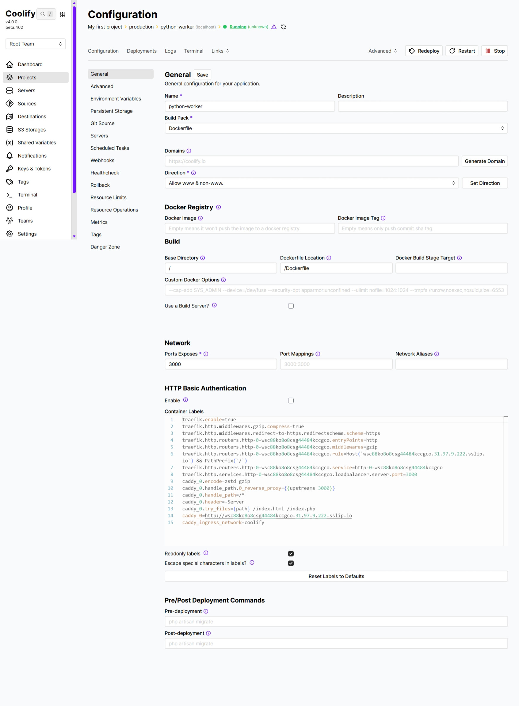

I have a n8n hosted on VPS with Coolify panel and I want it to run at some point in the workflow to run a Python script hosted also on the same VPS. I have created a Python worker container on Coolify so I can make it control all Python work (picture 1)

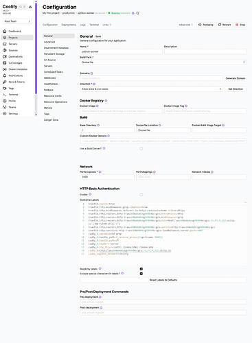

This python-worker container was created on Coolify using a Github repository has a dockerfile (picture 2)

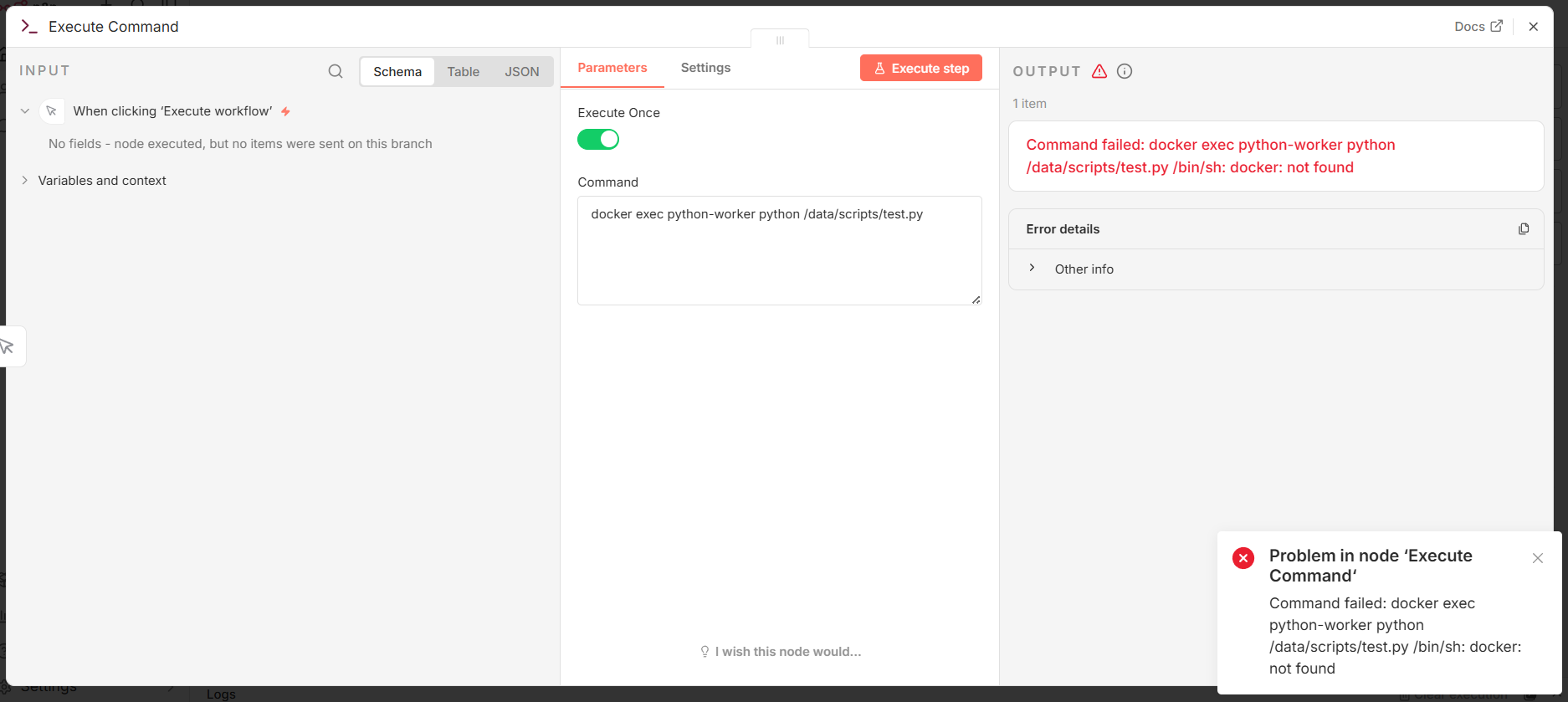

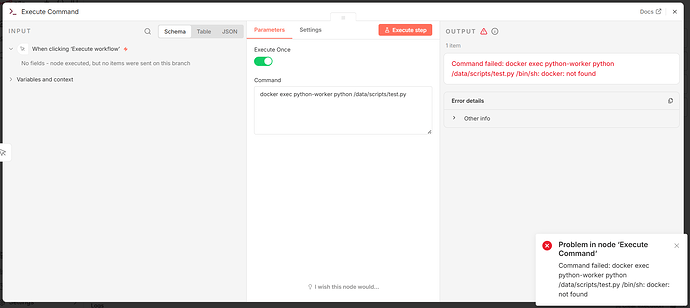

when I tried to run the container from inside n8n workflow with the execute command node (picture 3)
I got the error you see “/bin/sh: docker not found”
Am I trying to run the scripts in a right way? and where is the issue here

Most likely: You are trying to run the docker command from inside the n8n container, but the n8n image does not have the Docker CLI installed or access to the host’s Docker socket.
Try:
• Add an SSH node to your workflow instead of the “Execute Command” node.
• Connect the SSH node to your VPS host IP using your server credentials.
• Execute the command docker exec python-worker python /data/scripts/test.py via the SSH node.
• Ensure the SSH user has permission to run Docker (add the user to the docker group).
hope this help!
