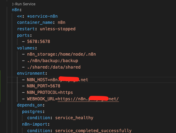

Custom DNS with caddy as reverse proxy, pointing to docker compose ran ollama and n8n both hosted on same server.
in compose I have added the env too for n8n but not sure why this is happening

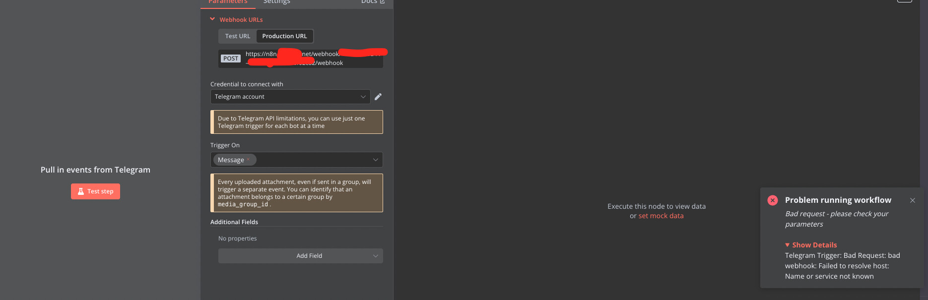

If not til ollama but still a simple telegram on message is also not working as expected.

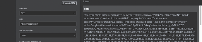

Can you confirm with a basic HTTP node to something like google.com, that DNS is working and you can correctly fetch something?

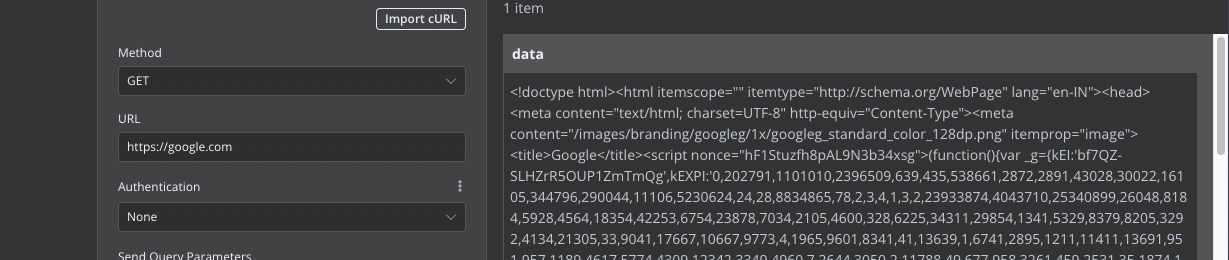

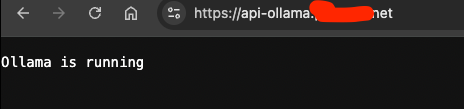

The google.com fetches correctly with https://google.com

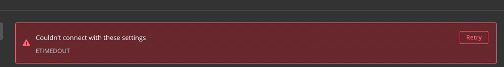

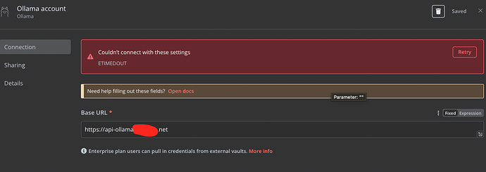

But when called the internally hosted ollama api end point it fails/ timeouts the request.
My only assumption is we have implemented a VPN (tailscale) to connect to our on premise server and only with whitelisted machines those api endpoints are accessible.
Even if I’am calling from a white listed machine not sure the end point know who is calling in a network level?
Any ideas or thoughts on how to proceed and possible help?
Thanks for your time.
