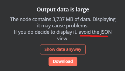

You can also open the dev console (f12) and check what is happening in the Network tab during the JSON opening. If there is a network issue, you will see a lag (increased time). Like this one
