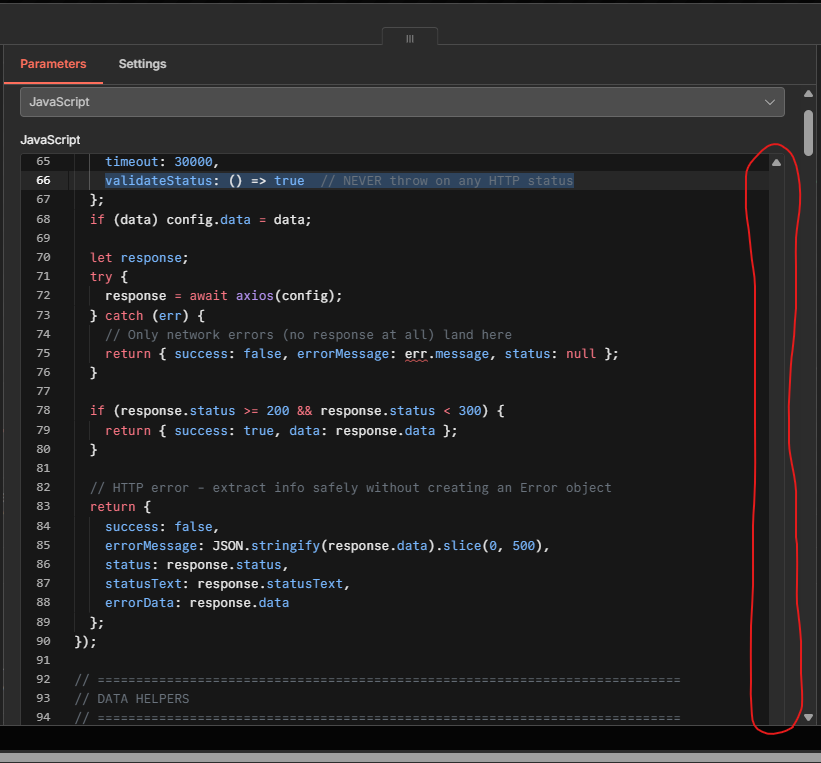

  2. The code nodes code screen doesn’t fit the screen, it puts a scroll bar within a scroll bar, I have to scroll all the way to the bottom to see the find option or pop out the code into focus. Example image attached.

The double scrollbar in the editor is a UI quirk that shows up on some screen sizes in the newer UI. Popping the editor into focus or reducing the panel width tends to remove the nested scroll container. It looks like a layout issue rather than anything related to the workflow itself.

yeah Marvel1 covered most of it. the try-catch on top of validateStatus is basically how we ended up handling it too, thats what keeps the runner from seeing unhandled rejections on 5xx responses. for the scrollbar, hitting the expand button on the editor tends to fix it, or just resize the panel.

For the UI part, that also sounds consistent with an editor layout issue rather than anything execution-related, so it probably deserves to be tracked separately from the runner behavior.
