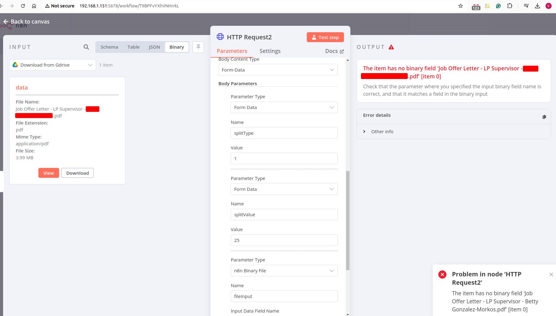

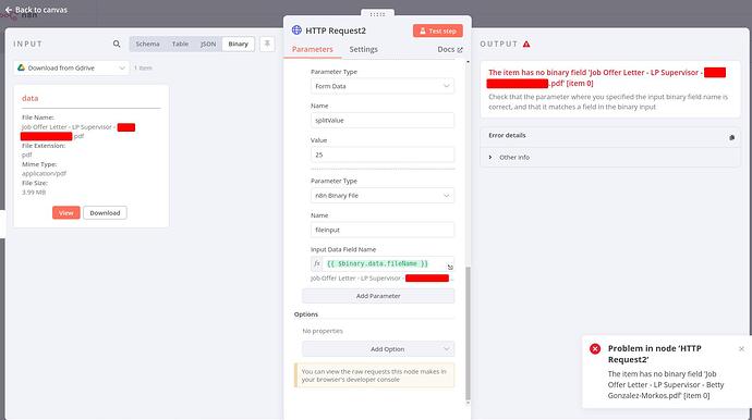

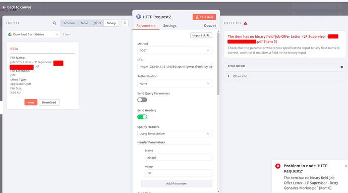

I have a very simple scenario, with 3 nodes:
  1. Gdrive checked for new PDF files
  2. Gdrive downloads the new pdf file
  3. HTTP request to Stirling PDF to remove specific pages.
The first two nodes work fine, the issue with the HTTP request that keeps giving the same error, no matter how I change the parameters.
Can anybody help me to fix it?

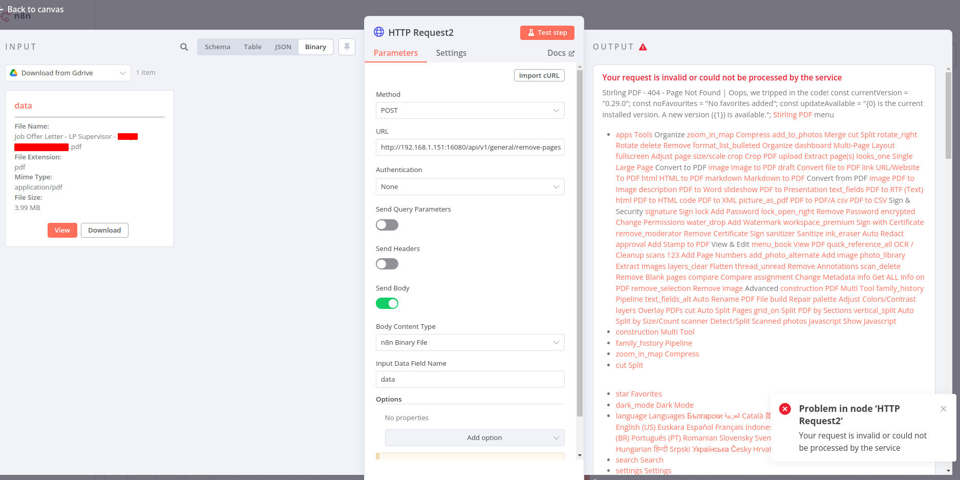

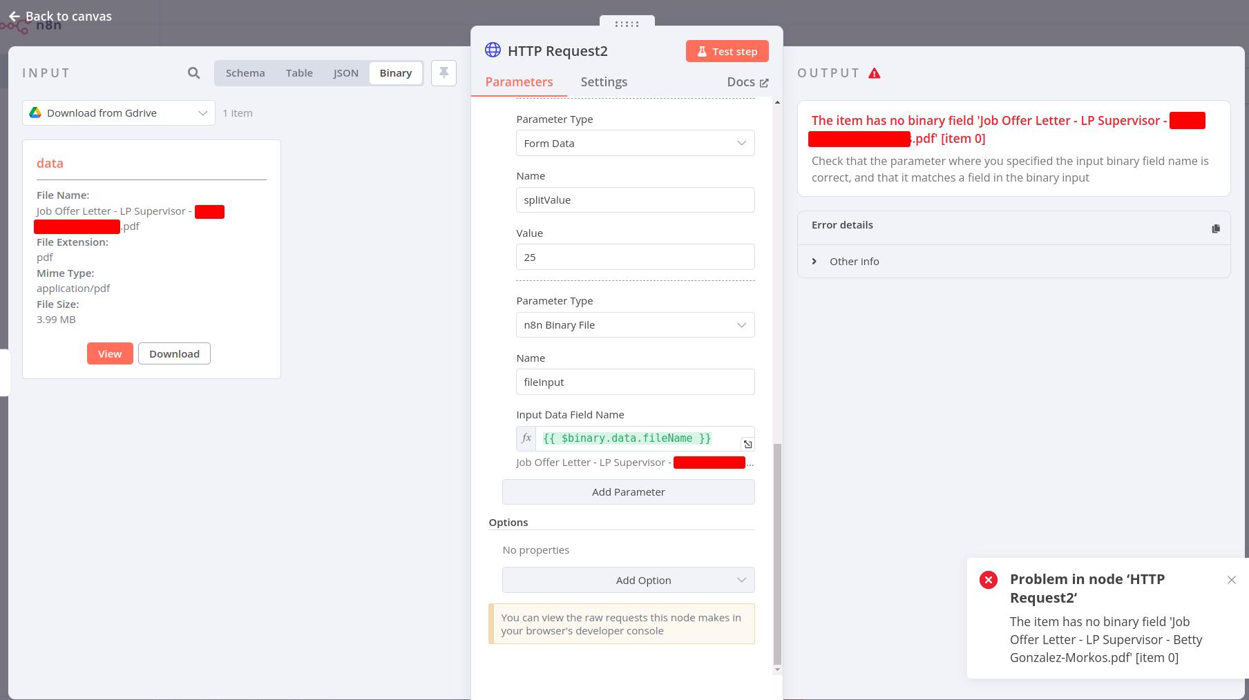

Hi @life.tripod ,
Can you try like this? - use “data” as the file name and not the actual file’s name
I am getting a different error now. If I understand what the error means, it is telling me that there is a new version of Stirling PDF, the 0.29, but that is exactly the one that’s installed
solved, i needed to add more parameters. Not sure why n8n does that.
