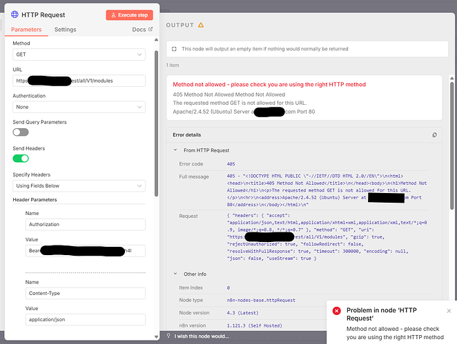

N8n to Magento API call fails ( curl works fine)
I have the n8n selfhosted in docker on-prem, our magento is on aws, I can curl the magento with out any issue (curl -X GET “https://xxxxxxx.com/rest/V1/modules”
-H “Authorization: Bearer xxxxxxxxxx”
-H “Content-Type: application/json”)
but doing the same in n8n as the first step, it shows me “Code 405, The requested method GET is not allowed for this URL.”
Any idea why?
Code 405. The requested method GET is not allowed for this URL.
This is the first step API call to Magento
  • n8n version: 1.121.3
  • Database : default Docker deployment
  • Running n8n via : Self Hosted Docker
  • Operating system: Ubuntu24
hello @ROOTLOOP
The example and the URL in the HTTP Request node differ. There is a part with /rest**/all**/V1 which is differs
that was just one of my attemps, I tried “all” , “default“ and without them , all got the same 405 code
I would suggest running the same curl command from inside the n8n container to confirm it reaches the same endpoint, and also checking whether the request is being redirected to HTTP before reaching Magento.
Another interesting thing is that the Apache is answering you on port 80, and you are requesting on port 443. Which may indicate there is a network issue (routing/subnetting/dns)
