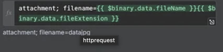

Hey @Sandro
It seems like you need a full stop between filename and file extension, it seems to be causing it to think it’s a different file type,
WP Extra File Types Plugin — WordPress.com which if using other file types u can use this, but am quite sure jpg is already acceptable, so it’s likely the full stop needed.
This is the node I have
Best regards,
Samuel
