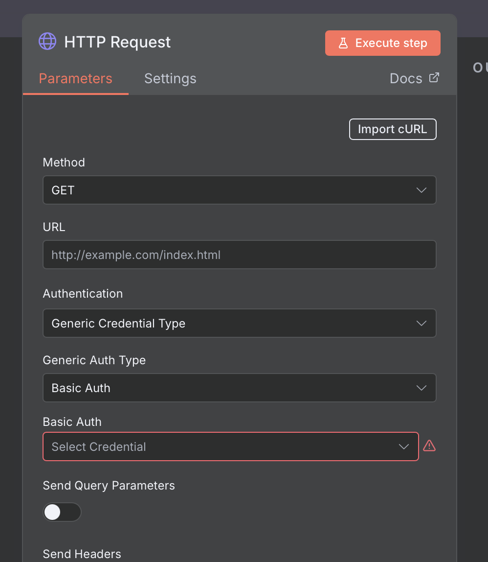

As per the documentation of mailjet it uses basic auth with the secret and id as your username and password.
On the http node, select the basic auth option and then create a new credential

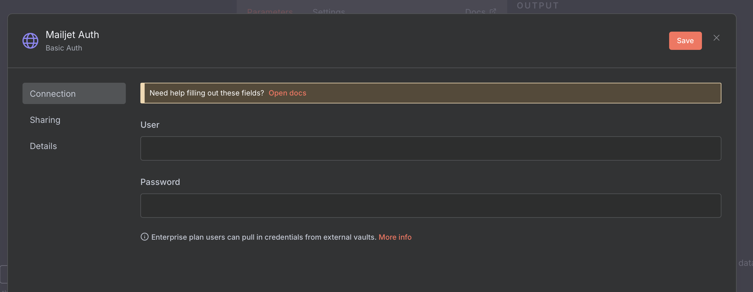

Give the connection a name in the top left and then use the api key as username and secret as password as per the documentation and click save

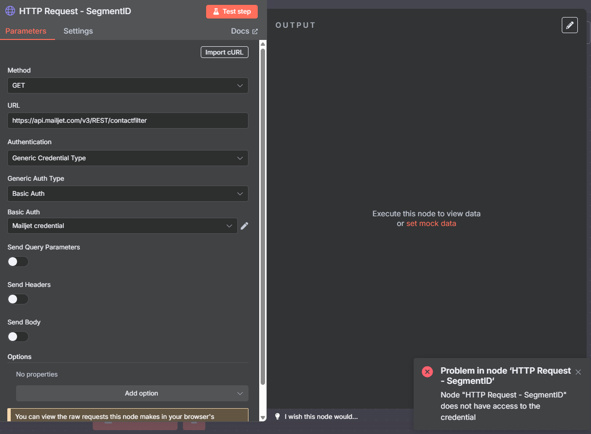

Thank you for your help, but that’s exactly what I’m doing. When I make an HTTP Request, I get the following message:

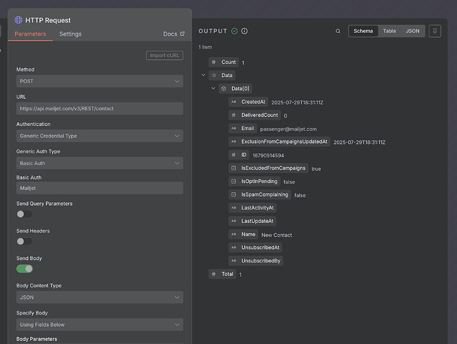

Then you might have added the auth incorrectly. I created an account now and added a contact from an http node. Can you check if you can run this node using your credentials.

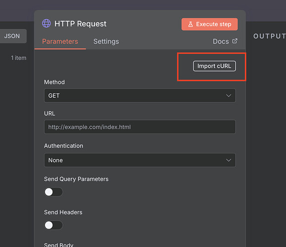

Oh wait I see the issue. You’re using a GET method on the contactfilter for segmentaiton. I believe there is only a POST available for creating segmentations. If you want to copy the api into n8n, click the copy button on curl from the api documentation:
Then create a new http node and click the import curl, then paste and click Import
This will fill in the http node properties correctly. Then disable the header toggle to remove the copied auth and then set to your basic auth
