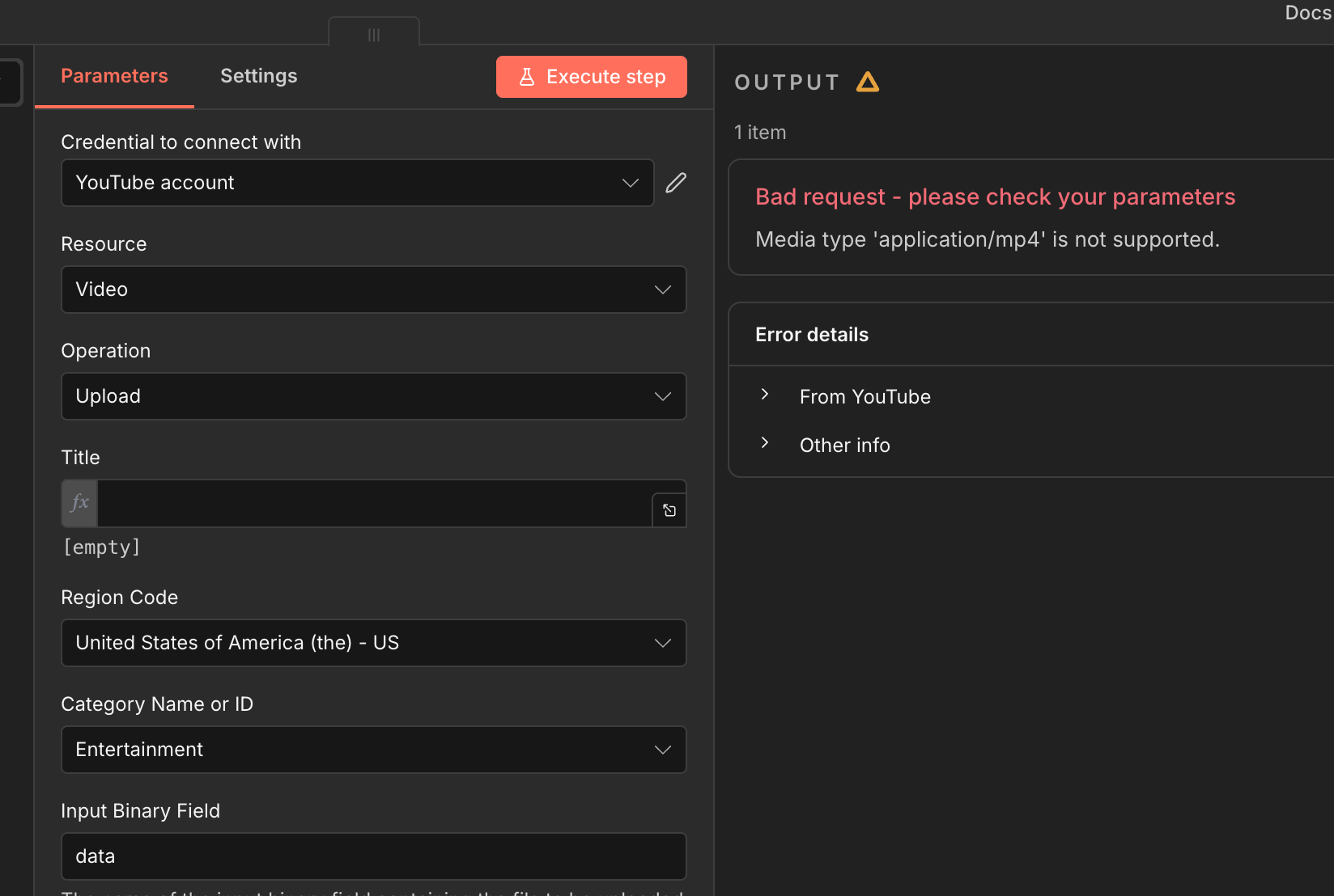

i had a working flow: read file from my local downloads folder, upload to youtube node, pretty straight-forward. I have a local docker set up, and before between these two nodes, I have a code node basically doing `item.binary.data.mimeType = ‘video/mp4’;`, and that was working.
However, youtube node always has this bad request, I don’t know if it’s the new binary data set up breaking it or something else is breaking it. Also it is not recommended anymore to directly modify binary data.
my docker-compose.yml is here

i tried ffmpeg transform the video to clean mp4 as well, doesn’t work
same problem bad request because of the media type and i changed it to video/mp4 but it still reading it as application/mp4
My workaround - change ffmpeg output filetype from .mp4 to .mv4
Long answer:
If you’re using FFmpeg → Read/Write Files from Disk → YouTube Upload and get: “Media type ‘application/mp4’ is not supported” this is not a MIME setting issue.
The YouTube node ignores $binary.mimeType and infers the type from the filename.
In some environments, .mp4 maps to application/mp4, which YouTube rejects.
Workaround Fix
Change the FFmpeg output filename from .mp4 to .m4v.
.m4v is still an MP4 container, but YouTube infers a valid video/* type.
Example: “ffmpeg … -f mp4 /data/video.m4v”
Then update Read/Write Files from Disk to read video.m4v. Do not change video/mp4 in the Read/Write node
Result
YouTube upload succeeds immediately :slight_smile:
