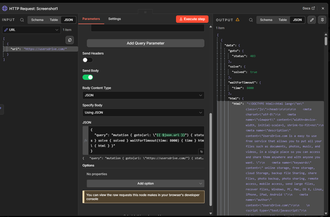

I tried this on my end using the attached URL in your workflow, but I couldn’t even find it, It sounds tricky, either I’m missing something or Cloudflare is doing its bot-detection thing, I’m not really sure..
Since your goal is to get the website content that requires solving a CAPTCHA, and you asked for a solution, I would recommend using a browser-as-a-service like browserless.io, They include CAPTCHAs solving in their generous free plan, so you just need to call the BrowserQL endpoint:
https://production-sfo.browserless.io/stealth/bql
With a query like this:
  "query": "mutation { goto(url: \"{{ $json.url }}") { status } solve { solved } waitForTimeout(time: 8000) { time } html { html } }"
This should solve the CAPTCHA,

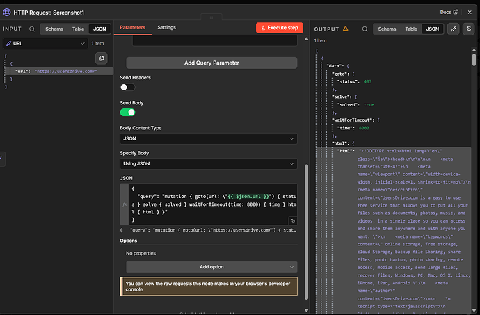

Here’s a test using your URL:
And here’s the example, just replace the token with your own:
