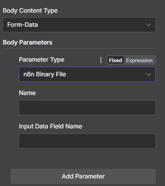

why are you using the Code node to make the HTTP request? For sending a file in the payload, you can use this approach:
I tried that too… placing the file on the name and binary file on the file but didn’t work.

Could you please attach any information, such as screenshots of the error you’re encountering with this approach? I’m unable to replicate the attached workflow on my end.

Yeah haha, i didn’t tried with the Binary File node before, i’ll make a backup and try this new way.
@mohamed3nan don’t work, tried everything :frowning:
