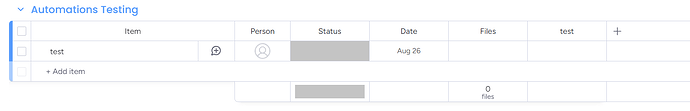

For reference, here’s what the Monday board looks like

I did not try that, but the issue wasn’t really the JSON structure so much as the column naming values. You have to turn on developer mode within Monday and then use the column ids that are only visible then. Cheers tho.
