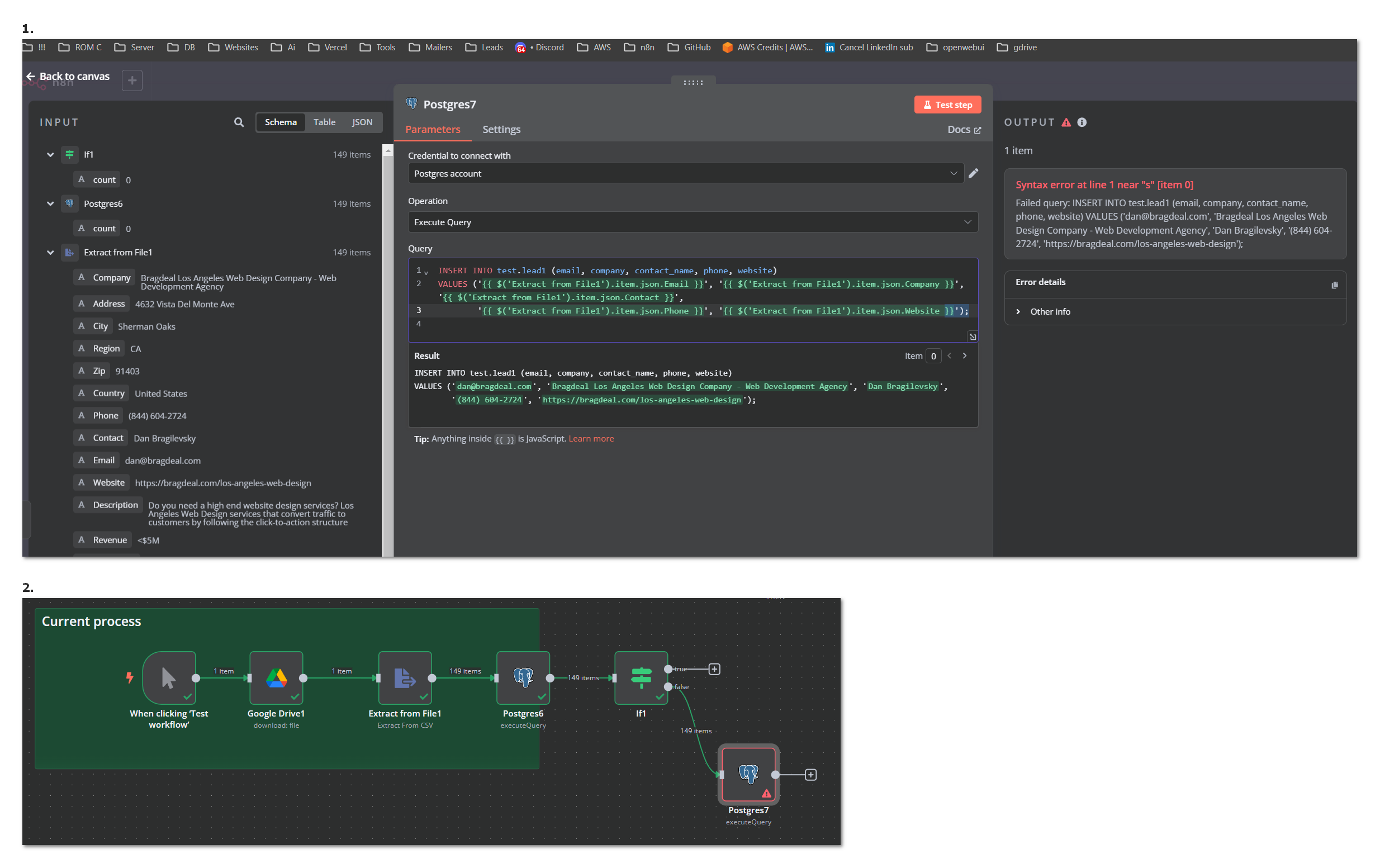

Need some one help with this node
the problem indicate while adding data to PostgreSQL
Hi, you would surely need a way to escape the special characters correctly before trying to insert them. there are specialized libraries for this. it depends whether you are self-hosted or not if you are able to use them. another option would be to regex in a code node or something similar
yeah I think so but I’m not that PostgreSQL expert only 2 days with it hope someone can help
maybe clean it first? but what special chars should it be?
I’ve setup 2 instance (docker compose) one on ec2 (aws) this one is on my local machine but use https via Cloudflare tunnel
Hi, I think the URI / URL characters pose a problem like ‘/’ etc. Just to confirm my hunch, try to manually edit the values to contain only non-special characters. like (test1, test2, etc) to confirm everything else is working. then you might want to lookup what the special characters are and/or ask chatgpt to create/build an example function for a regex in js that can escape special characters for SQL. but the first thing is to confirm whether the problem is what we think the problem is. just try with test values.
that’s the plan thank you very much mate have a good day
no problem.
