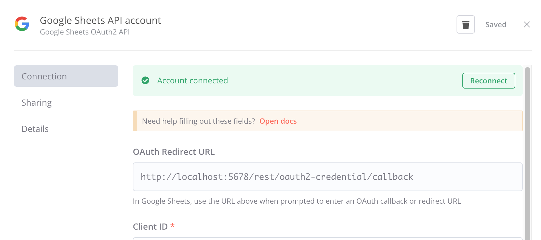

The creds i use (i’ve created this cred from the scratch):
I’ve tried to workaround the issue i mentioned before (about the “sheet by id”), so i used “sheet by url” now, and still i cant get the list of columns
