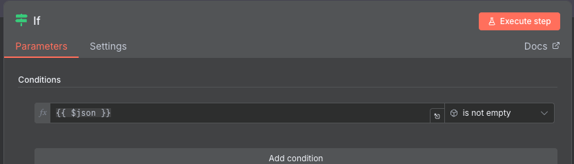

Go to the supabase node’s settings and enable “Always output data”. Then follow the node with the IF node and the condition should be {{ $json }} object “is not empty” to check if there were results.

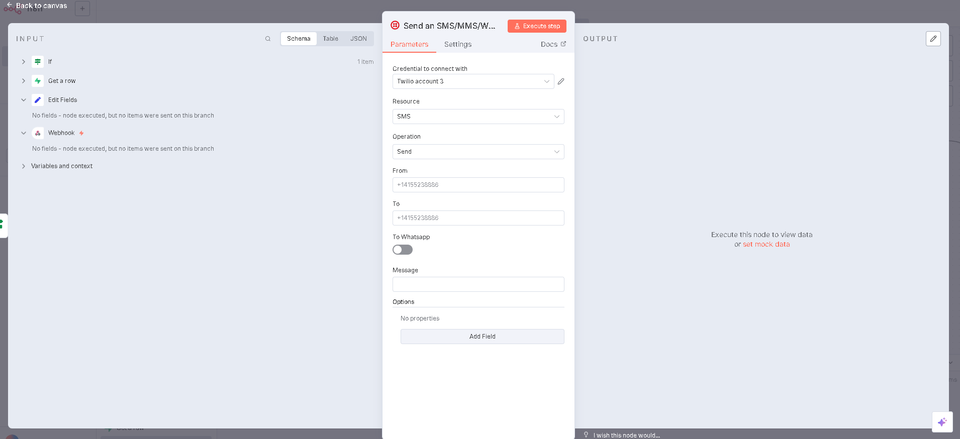

Thank you. i have a problem i woud like to send a message on twillio but the data is blank when i was on the False condition.
This appears to be a separate issue, please mark the answer as solved here, then create a separate topic for the new question. Thank you.
