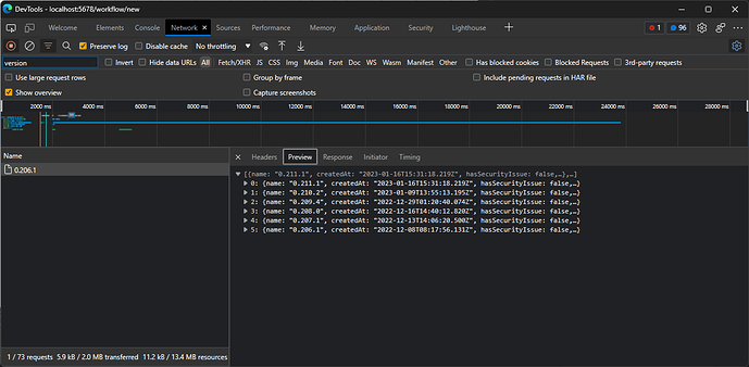

Hi @daniello, I’ve just started an [email protected] instance using docker run -it --rm --name n8n -p 5678:5678 n8nio/n8n:0.206.1
. As soon as I create my first workflow, the available update info shows up:
Update notification:
Version information:
Available updates sidebar:
So this is most likely a setting on your side. The N8N_VERSION_NOTIFICATIONS_ENABLED=false
environment variable would prevent this notification from showing up for example. Ad blockers might also cause this behaviour if they interfere with traffic to https://api.n8n.io/api/versions/*
(which would return the available versions):
Do you get the upgrade notification on your canvas (after clicking Add Workflow)? If not, how are you running n8n?
