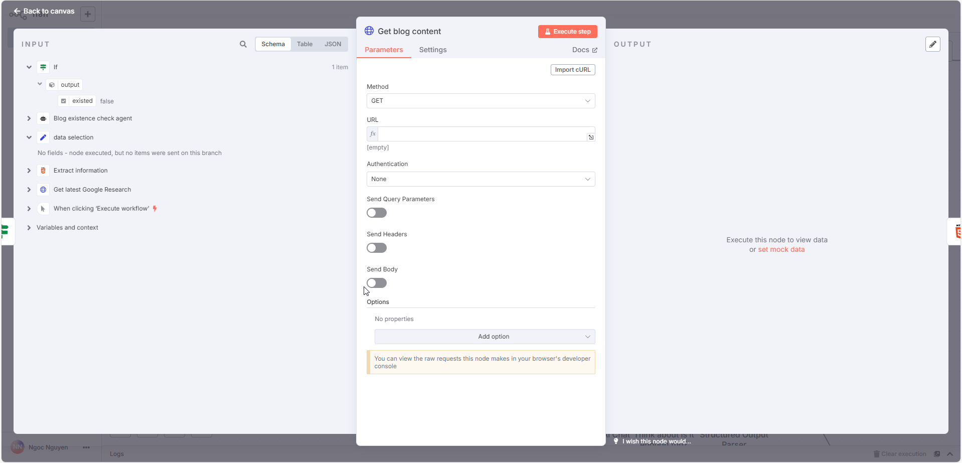

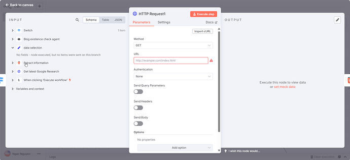

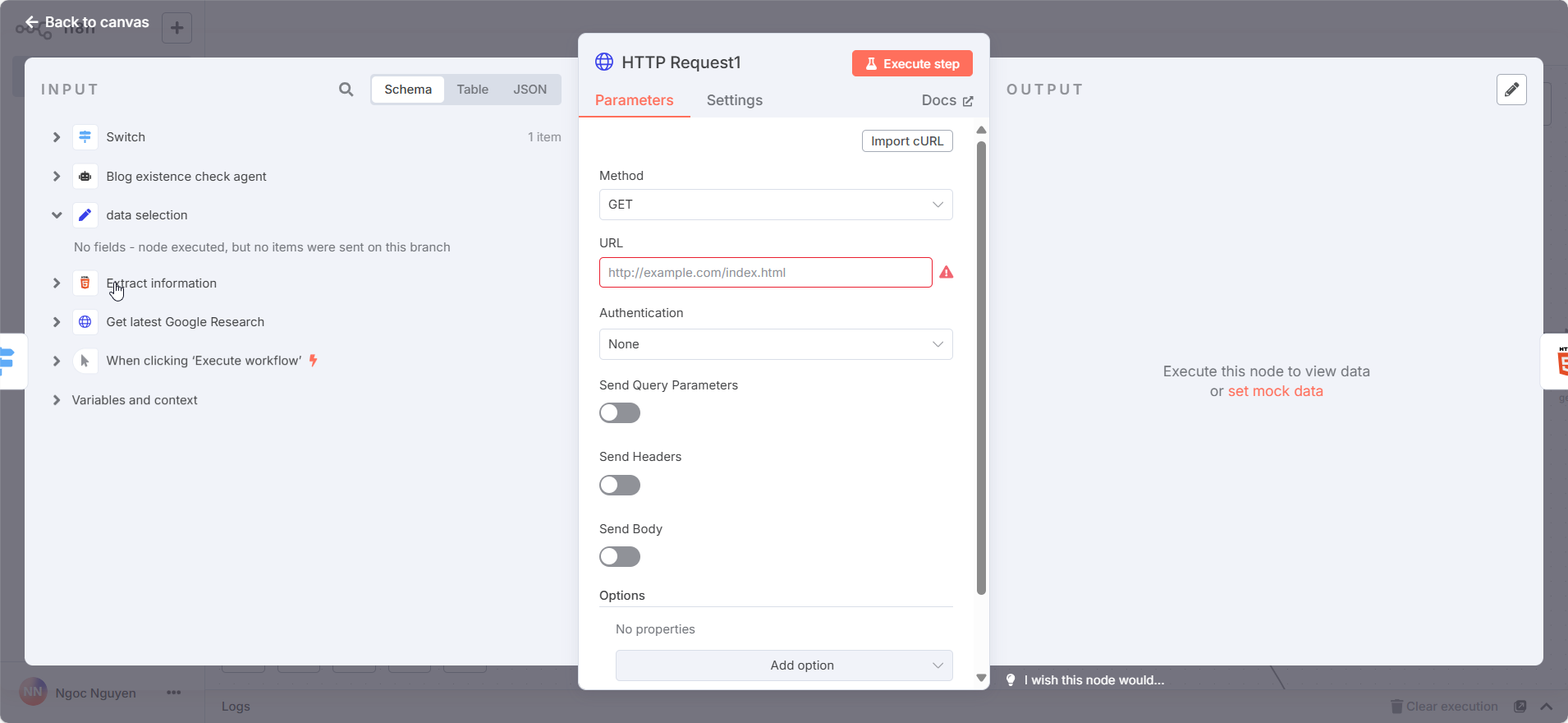

After my agent runs, it returns a boolean output to check the existence of data. With this output, I process two branches in the Switch node. Actually, I first used an If node but encountered the same issue, so I switched to the Switch node. If true, it processes A (code node); if false, it processes B (HTTP node). However, data from previous nodes is only transferred to the first branch, and the second branch is blank. If I switch the branch order, data is still only transferred to the first.
No fields - node executed, but no items were sent on this branch
Code node with data from previous ones
HTTP node with no data

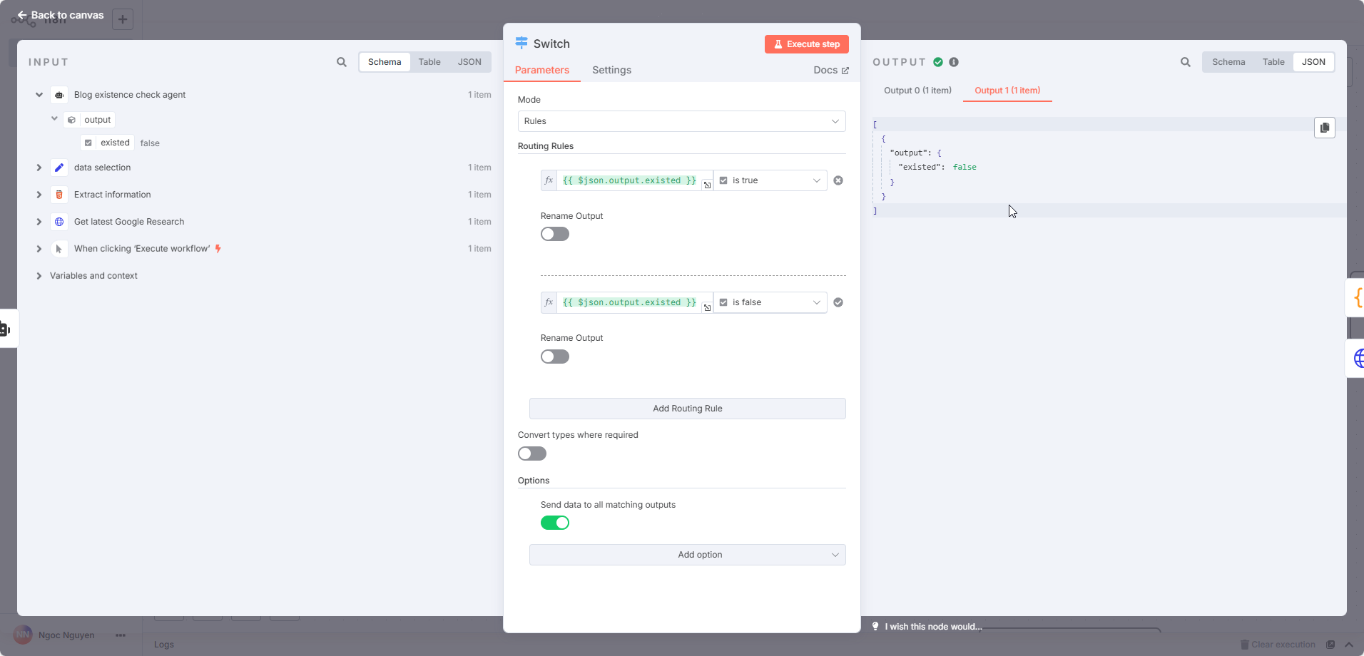

Can you show us the results of Switch Node and AI Agent Node?
Here is the result of Agent node. As you can see, false/true is boolean type
Here is the Switch node if I change condition to string
Here is the result of Switch node in boolean condition

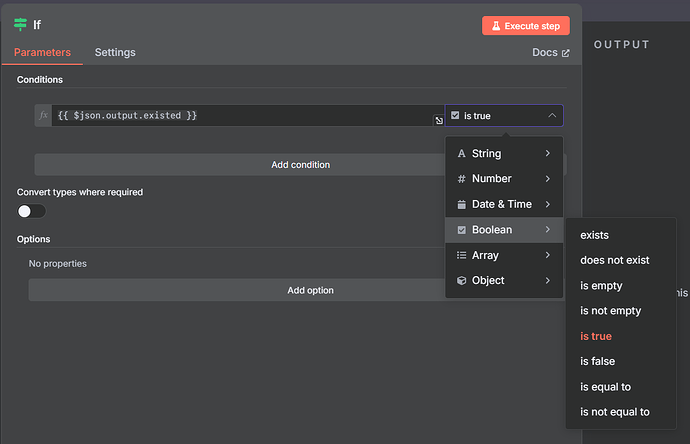

You actually don’t need switch node.
You can use If node again, and change the operator type to Boolean > is true or is false

It doesn’t work, though. I also used the If node at first. And I tried again following your recommendation, but the result is the same with the Switch node.
Can you show us when you’re using If node?
Enough data at If node
After running, although the result is false, true branch contains enough data
While false branch contains nothing
I found a lot of people met the same issue as me. But not sure to resolve this. I cannot upgrade n8n because I use it in sandbox of my company

As you can see, I have true/false branches to continue the next appropriate process. However, data is only sent to the first branch, and the second branch has nothing, so I don’t have data to continue the process. For now, I’m using a temporary solution by connecting the second process directly to the node before the Switch/If node to get the previous data.
What data you need from the previous node to continue the False condition process?
data from “data selection” node
