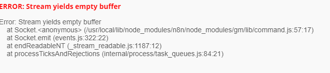

Jan, your sample dont work with pdf right now ? Right ?
Yes, it does at least if you have graphicsmagick installed.
Must GraphicsMagick installed in the docker container ?
What docker image are you using? One of ours or one you did create yourself?
yours i use it.
That is strange. There it should be installed by default. Will have a look.
Not sure why but for some reason does it not seem to like graphicsmagick in the Alpine based image. So if you are currently using n8nio/n8n:0.75.0
switch to the ubuntu based one n8nio/n8n:0.75.0-ubuntu
. There it will work fine.
