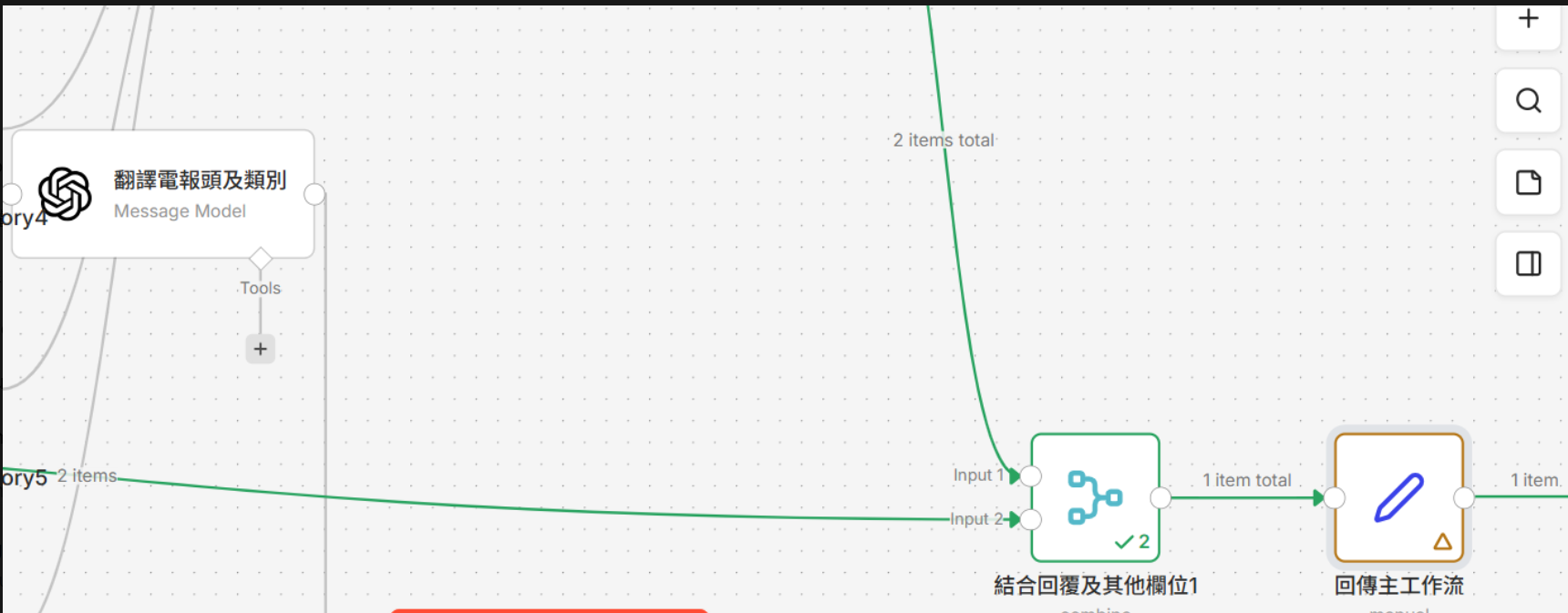

Yes, I guess refreshing might be an issue. Here is another case I suspect involves view refreshing. (There are other cases but less straightforward, will provide the possibly more robust ones only.)
What confuses me about the below screenshot is not two incoming nodes each with 2 items end up as 1 item after merging, but that at the time of the screenshot, the execution copied to editor had badges showing “two items from each input, but only one outputted”, but minutes later, the badges for the same execution became “one item from each input, but only one outputted”. "
I saw the badges for item number changed when I clicked on the same execution and clicked “Copy to editor” again shortly after the first screenshot.
Sorry I didn’t have a chance to screenshot the “one item each from the inputs, 1 item outputted by Merge“ view, but I’m pretty sure I was looking at the same execution, as my executions are hours apart and have to be triggered manually.
FYI, below are the output json of the two inputs. The jsons suggest that they actually each have 1 item only.

Hi @Anshul_Namdev Thanks! Will make sure that I know the basics. Although I have taken the Level 1 course of n8n’s site and built several workflows that work, there are nodes and logic that I haven’t quite figured out. My post was to make sure that what I see is what I get.
Since you’re on 2.12.2, I’d also strongly recommend testing this on the latest version if you can. If you still see the same badge counts changing for the same execution after updating, that would make this much more interesting as a possible editor/UI issue.
the sub-workflow trigger behavior can seem confusing, but it outputs null until the workflow is actually published and called from another one. thats what youre seeing in the UI, not actually broken, just how n8n displays that trigger type in dev mode. the data flows through fine once youre actually executing it with real input, but the visualization isnt updated in the editor because the trigger hasnt been fired. try publishing the workflow and calling it from another one to test properly
Thanks a lot. Will try updating. :slight_smile:
Hi @Benjamin_Behrens Thanks for helping. This sub-workflow actually was published and called by the main. :slight_smile:
Although it’s possible that I forgot to publish the subflow for an execution occasionally, but such situation happened multiple times, two of them shown by the screenshots (one is the “skipping” visualization and the other the “badges for item number was one but became one input when the same execution was re-loaded”) . So the cause is probably not my forgetting to publish.
The badge issue might be related to how n8n refreshes the execution state in memory. Try clearing your browser cache or reloading the editor tab — sometimes the UI gets out of sync with the actual execution flow. If it persists, check your n8n version (especially if you’re on an older 2.x release) — there were some fixes around execution visualization in recent updates. Let me know if that helps!
Hi @Benjamin_Behrens Thanks a lot! Before updating my n8n to the most recent version, I report this bug (I suppose) to n8n to make sure that one of the bug fixes have taken care of that. Will let you know once I get a reply. :slight_smile:
