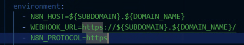

So to confirm, which env vars are you using? It seems u have ngrok, so which URL do you access the GUI from (confirm its not localhost), and which URLs do you see on the webhook node?
In essence, you need these, it would appear inside your composer file:
You can either place actual values in the .env file or docker-composer
environment:
- N8N_HOST=${SUBDOMAIN}.${DOMAIN_NAME}
- WEBHOOK_URL=https://${SUBDOMAIN}.${DOMAIN_NAME}/
Or you can just add to you host if not using dockers using export etc.
Hopefully that fixes it.
