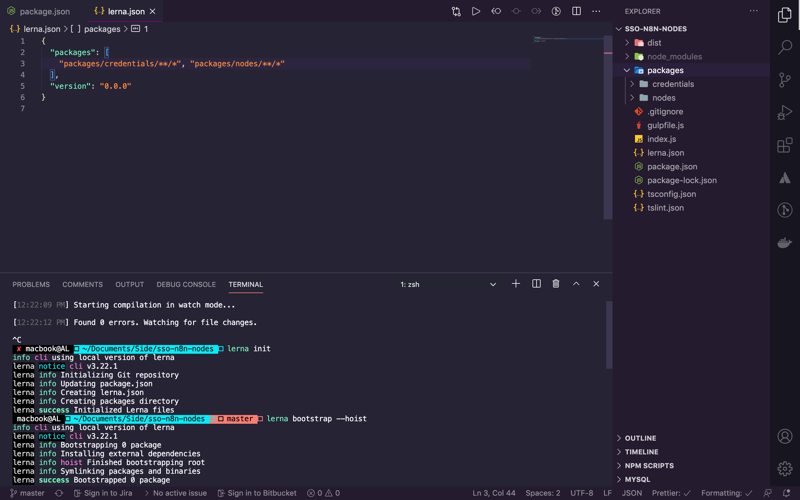

Hi Jan, i followed your instructions and still got same here. I attached screenshots and here’s where the files are hosted on github.
It looks like you started a totally new “folder structure”. You have to add your new module alongside the n8n-packages for it to work. So alongside this ones:
