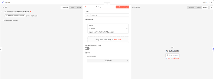

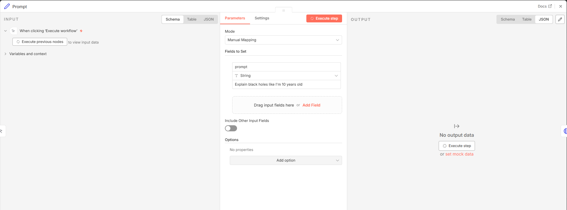

Hi , I run workflows ,which are workable before, not work. Some of them run and keep loading. For some workflow, it not work even I run the executive button (no response at all). i have redeploy and my version is 2.3.6
im not sure but it looks like you’ve redeployed and your workflow version is 2.3.6, which is the latest stable release. can you confirm if you’re running the exact same configuration as shown in the images and if there’s anything specific that’s changed?
also, since some workflows are loading indefinitely without error, i’m curious to know more about those specific cases - do they share any common nodes or configurations?
The config is the same; it review the log in Railway (self host) and I notice there is an error. Any idea how to fix it?

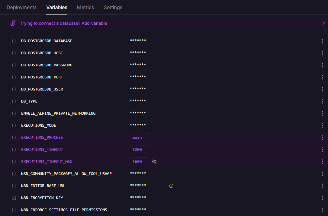

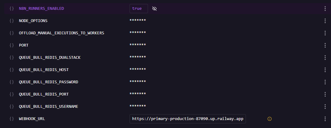

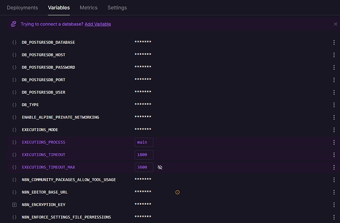

  • My Railway setup is a Queue Mode configuration consisting of four interconnected services:
  1. Primary: Running n8nio/n8n via Docker.
  2. Worker: A dedicated worker node is online.
  3. Postgres: Used as the main database with a persistent volume.
  4. Redis: Used for the execution queue with a persistent volume.
  Key Variables:
  • N8N_RUNNERS_ENABLED: true
  • EXECUTIONS_PROCESS: main
  • EXECUTIONS_TIMEOUT: 1800 (Max 3600)
  • All Redis connection variables (Queue Bull) are mapped to the Redis service
    Attached list of variable name for reference.
