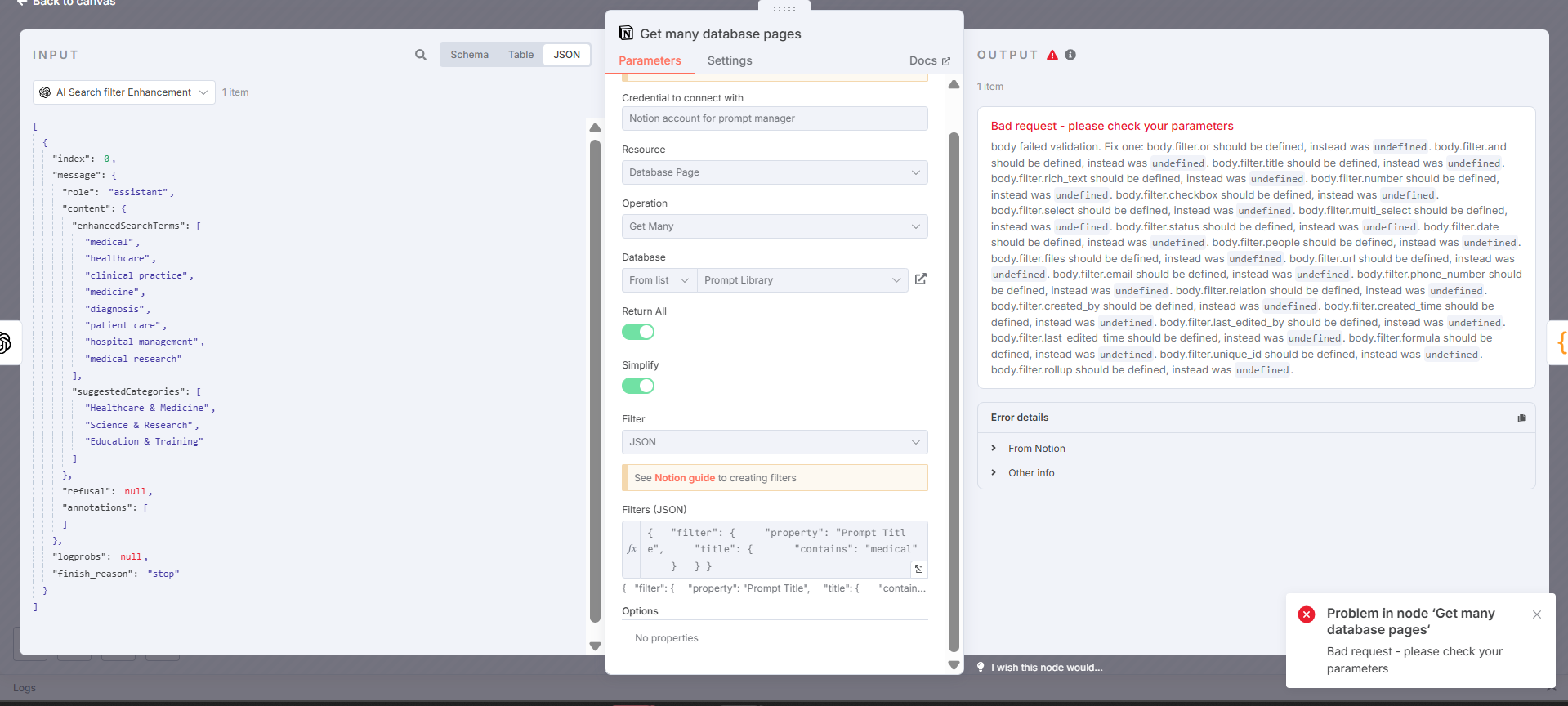

Notion node filter JSON isnt working. I get a abd request error . I am forced to filter later using a code node and then have issues there which are getting complex. Why cant Notion simply work with a JSON filter. I tried both fixed and expression

Initially, I had the same issue you were facing - it boils down to the content of the filter expression field. Given your screenshot, it looks like you are adding the key “filter” to the payload, which I assume is there by default already.
I am pasting an example below with a payload that works so that you can start from there:

I want to use the Notion - Get many database page with a filter to get only notion pages where the attribute Description contains “abode” or “build”
Steps to reproduce
  1. Log in to your n8n account
  2. Go to a workflow view
  3. Add a Notion - Get Many Database node
  4. Select JSON in filter and select expression
  5. Paste the following payload
  "or": [
      "property": "Description",
      "rich_text": {
        "contains": "abode"
      "rich_text": {
        "contains": "build"
  1. Execute step
See settings below
Expected results
  • Only pages that matches the filter (in this case 7)
Current results
  • :white_check_mark: Only pages that matches the filter (in this case 7)
