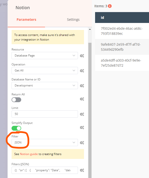

Hi @Shirobachi, just wanted to drop a quick note to confirm I could reproduce this, even with a brand new setup. I have documented this in our internal bug tracker and we will, of course, confirm once this has been resolved.
I was able to avoid running into this error when defining a JSON filter though instead of using the manual filters like so:
My exact value used for Filters (JSON) was this one (where Date is the name of my date field):
  "or": [
      "property": "Date",
      "date": {
        "on_or_after": "2021-12-31T23:00:00.000Z"
Hi there. I also ran into this problem. I assumed Notion may have tweaked the API…
I now also use the JSON filter instead. Nothing else worked for me.

If downgrading is not an option as suggested by @Shirobachi, you can also use the JSON approach shared earlier as a workaround @ZXS. It actually uses a date field, so all you’d need to change is the name of your field.
Oh, yes, I forgot about that you may want to read this notion documentation for knowledge how to write manual JSON filter: Query a database
