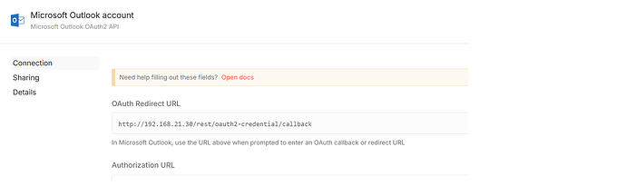

OAuth Redirect URL with outlook
since microsoft doesnt want to have http and want https
i try to change the address but it not working
i try to put WEBHOOK_URL=HTTPS://ADDR in the .env and docker-compose.yml
nothing change

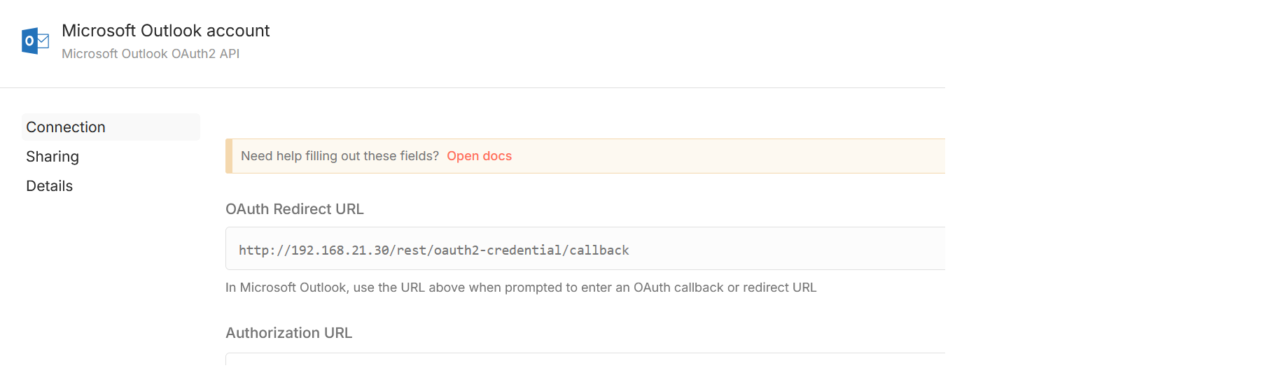

it has changed but when i try microsoft is not able to connect to localhost
theres is a way to do it
ok i have make a tunnel with cloudflare and now it working but the problem is i get this error with no info
