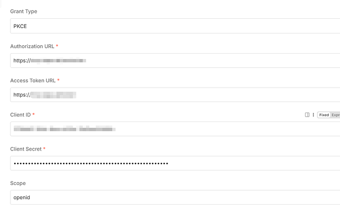

  • n8n version: 2.2.4
  • n8n EXECUTIONS_PROCESS setting (default: own, main):own
  • Running n8n via (Docker, npm, n8n cloud, desktop app):desktop app
  • Operating system: windows

I am linking to n8n docs MCP: https://n8n.mcp.kapa.ai/
Grant Type: PKCE
Authorization URL: https://mcp.kapa.ai/auth/google/authorize
Access Token URL: https://mcp.kapa.ai/auth/google/token
Client ID and Secret through https://mcp.kapa.ai/auth/google/register register

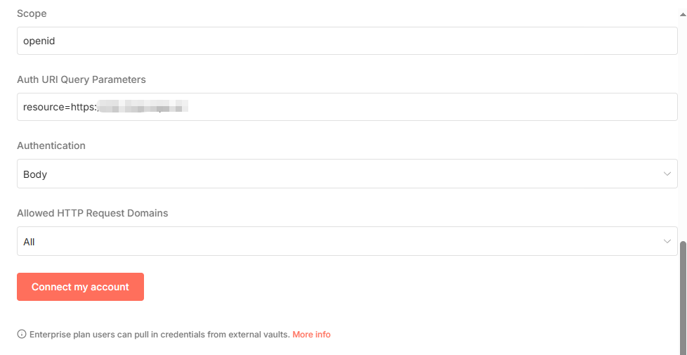

For https://mcp.kapa.ai/auth/google/* with Grant Type = PKCE, the most likely correct setup is public-client PKCE: set Authentication = Body, send token request as x-www-form-urlencoded, and often no client_secret (client_id must be in the POST body along with code_verifier).
If that fails, try the confidential variant: keep PKCE, set client_secret, Authentication = Header (Basic).
If both variants still return invalid_client: Missing client_id (while MCP Inspector works), that strongly suggests n8n’s MCP OAuth2 credential is omitting or misplacing client_id in the token exchange.
