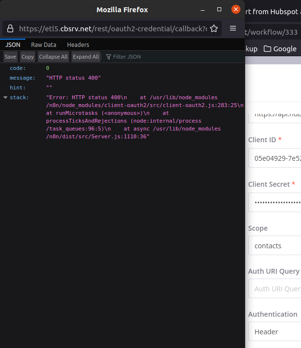

I have actually 2 issues here,
  1. The connection gets timed out or say the token expires and i get status code 400.
  2. while creating OAuth2 connection If I choose Authentication Header it doesn’t goes through, while I choose Body it works fine. My Guess is that not refreshing token on it’s own may have something to do with it.
I am using the OAuth2 with the Mautic API as well and there i am able to use Authentication Header and it gets refresh with no external efforts required. the issue seems to be with Authentication with Hubspot only.
