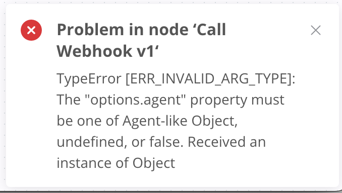

I recently upgraded from 0.222.1 to 0.236.3 and everything appeared to go smoothly including our workflows succeeding just fine for about half a day when suddenly we started seeing error messages when one workflow tried to call another webhook (workflow) through an HTTP request.
Now whenever we kickoff a workflow the first workflow will start just fine but the follow-up workflow will never be executed and the first workflow HTTP request will error out with “undefined” and an odd error message.
TypeError [ERR_INVALID_ARG_TYPE]: The “options.agent” property must be one of Agent-like Object, undefined, or false. Received an instance of Object.
Pretty much a JSON response with the above error message. I’ll post a screenshot but I forgot to copy the text unfortunately.

Hey @NealSr,
I suspect we will need more of the data, If we were to run the workflow that has the issue we will see other isses and not the one you have reported. I would maybe start by changing {{ $node["Requested Services"].json["url"] }} to just {{ $json.url }} to see if that helps but I am also not sure what the JSON results of function node 0 query actually is and the issue could be there.

This is the last time I saw an error yesterday.
Screenshot 2023-08-18 at 10.16.59 AM
Do you have an example of one of the other node versions failing?
I need the full stack error that would typically in the output for any errors.
